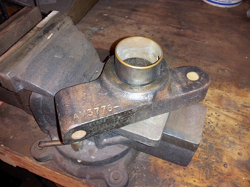

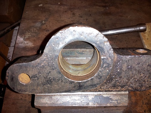

During my CA restoration I called Brenda at Sandy Lake for some rockshaft bushings. Mine were toast! She didn't have any but thought they were the same size as the camshaft bearings. I just finished the engine rebuild and had the old ones laying in the (large) pile of worn out parts. The old bushings are the right diameter but are not as wide. I cut two pieces out of the third bearing and used them to make up the width. This may already be common knowledge but I thought I'd share. I'm still figuring out the right picture upload size so I hope they're close.
