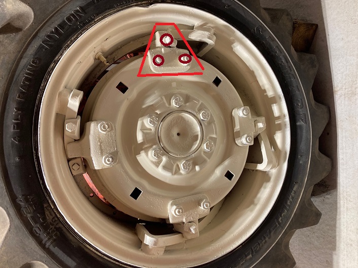

Post Options Post Options   Thanks (0) Thanks(0)   Quote captaindana Quote  Post ReplyReply Direct Link To This Post Posted: 27 Jan 2023 at 11:23am
So here’s what I have, how would those loop rims work?
Blue Skies and Tail Winds
                          Dana
Larry in NC View Drop Down
Joined: 09 Feb 2016
Location: NC
Points: 1050
Post Options Post Options   Thanks (0) Thanks(0)   Quote Larry in NC Quote  Post ReplyReply Direct Link To This Post Posted: 27 Jan 2023 at 11:38am
I posted a picture above, you have to change the centers to use four loop rims.
captaindana View Drop Down
Location: Fort Plain, NY
Points: 2572
Post Options Post Options   Thanks (0) Thanks(0)   Quote captaindana Quote  Post ReplyReply Direct Link To This Post Posted: 27 Jan 2023 at 12:38pm
Oh oh oh! Gotcha now! Thanks!

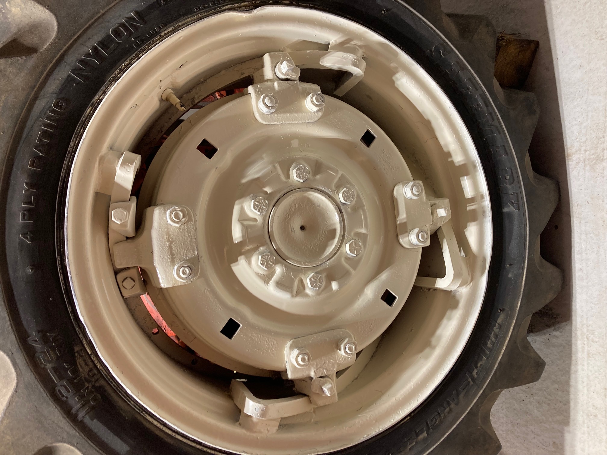

Post Options Post Options   Thanks (0) Thanks(0)   Quote WF owner Quote  Post ReplyReply Direct Link To This Post Posted: 30 Jan 2023 at 2:09pm
I have a D10 that I bought from an estate in Maine that did not have power adjust rims. The daughter that I bought it from really knew nothing about it other than it was her dad's and he used it for parades.
I'm thinking that the centers are not AC, but I'm not sure of that. Here are a couple pictures I took today when I was down where the tractors are.
