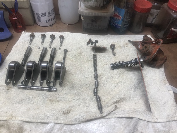

More disassembly this morning. Here's what's out of the pump thus far:
I've laid everything out in exactly the order it came out of the pump - no parts have jumped across the shop yet!

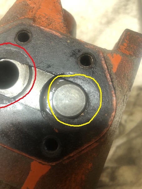

Couple of things I could use some help with. First, here's the the scene with the control valve cover off and the inner (smaller diameter) parts of the control valve assembly removed. Note the area marked in red:
How is the outer part of the control valve assembly removed? This is the other end of this assembly:
The red arrow is pointing to the outer part of the control valve assembly.
And how are the parts inside the bore circled in yellow removed? Hunt4Allis says they all come out......just a little concerned about trying to drive them out.
Any hints would be happily accepted! And thanks for your help.

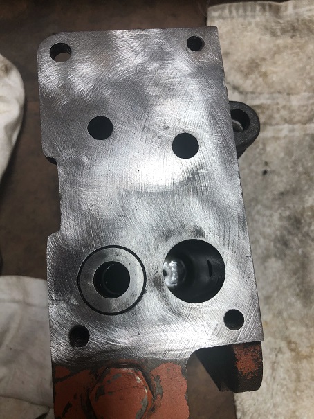

Started reassembling the pump by cleaning up the surface that mates to the drawbar control:
Hopefully this will all go well!

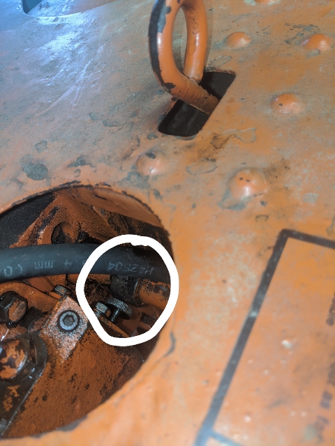

That's weird because my thumb screw that you're talkin about labeled d hits the engage PTO shaft and won't let it come all the way out
Hunt4Allis View Drop Down
Joined: 13 Mar 2018
Location: Ohio
Points: 1172
Post Options Post Options   Thanks (0) Thanks(0)   Quote Hunt4Allis Quote  Post ReplyReply Direct Link To This Post Posted: 05 Apr 2020 at 12:12pm
PTO engage shaft circled in white
Jim.ME View Drop Down
Joined: 19 Nov 2016
Location: Maine
Points: 974
Post Options Post Options   Thanks (0) Thanks(0)   Quote Jim.ME Quote  Post ReplyReply Direct Link To This Post Posted: 05 Apr 2020 at 12:27pm
It sounds like you are adjusting with the pump off the tractor, if so, it doesn't have the PTO control shaft to hit as Hunt4Allis pointed out.
