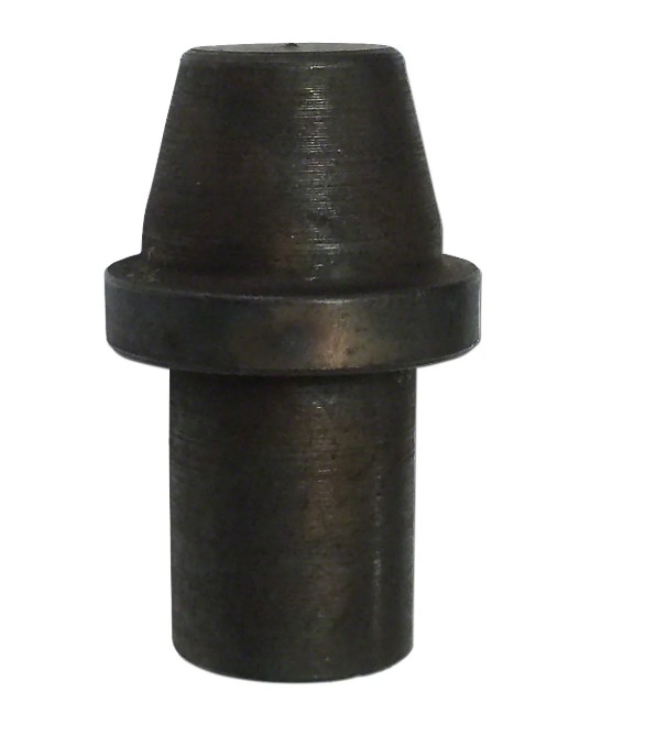

Hello everyone, my CA is back under its own power again and everything seems to be in good shape so far except for the loose steering, it keeps one on their toes in 4th gear!  I did a search on here about the problem but didn't find anything.  Did the same on Yesterday's Tractors and I did find a post there from back in May 2018, mentioning a pawl that engages the worm gear that gets worn, and that it was perhaps available from Deere.  Is this pawl available from them or Agco?  Would anyone have part numbers, or does one have to be made?  Are there any adjustments I could try in the steering boxes?

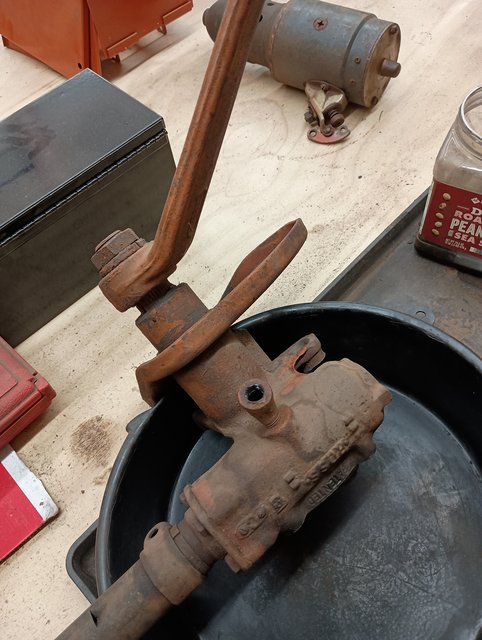

I was able to take most of the slack out of our CA steering by adjusting the "Ross" steering box..
Her is a pic of where to adjust the box. Just loosen the outer nut and adjust the inner with a screwdriver.
Still a small amount of slack after a slight adjustment, but not much.
Dan

Caution when adjusting the steering box if adjusted while the steering is centered you may get it tight enough to break the cover when the wheels are turned.to avoid this turn the steering all the way to the left or right then adjust it.

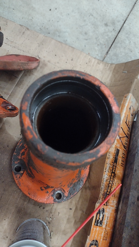

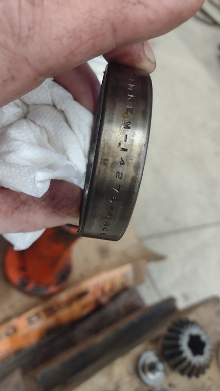

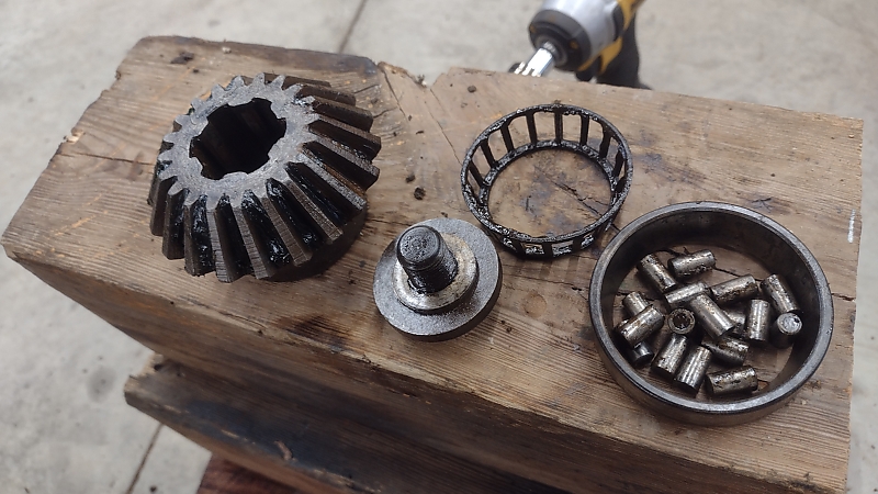

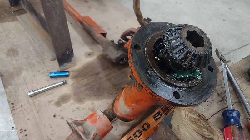

DCAC,

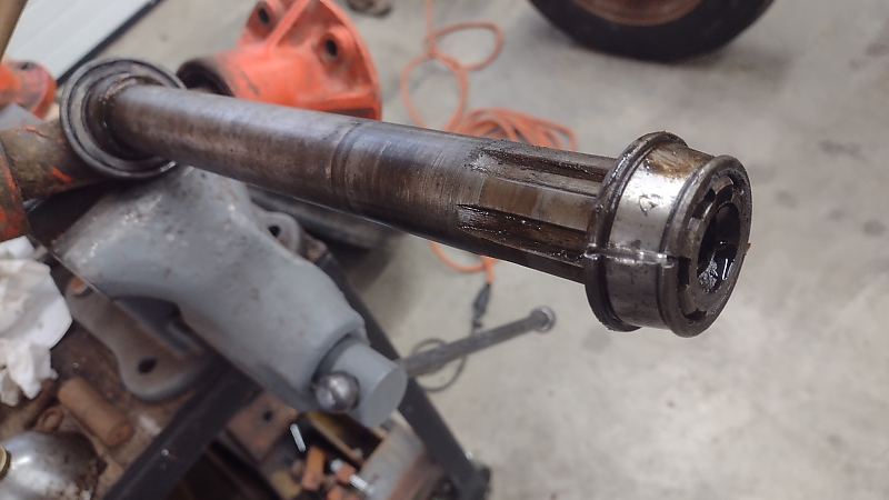

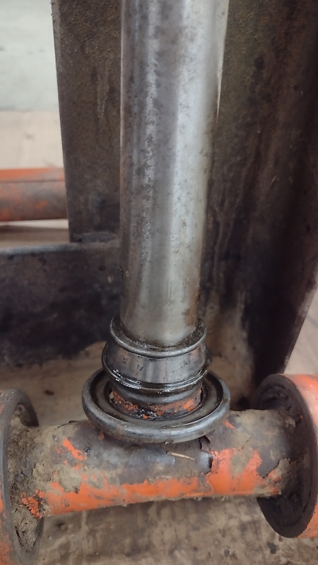

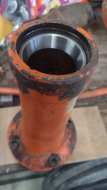

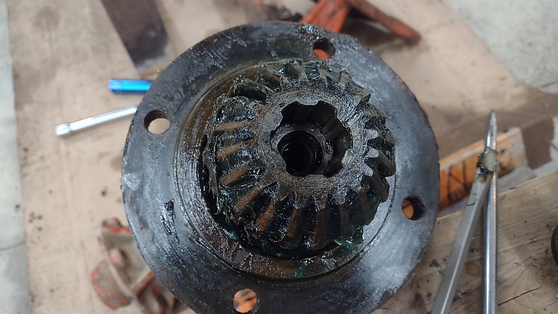

 I believe I did have the Ross steering box apart and cleaned and repacked and adjusted as Dan mentioned. I did change Ross boxes also. I must have found what I thought was the better of the two? Might be some pictures stuck in my CA thread? I also put new bearing in the lower pedastal I believe? Been a year or two. have CRS!
Some pictures that may be helpful?? Or not?
That is about all I could round up related to CA steering.
Ours steers pretty good. It had steering arm issues and the long bar issues too. All good now. It's only nuts and bolts!
 Chris and Cheryl
Edited by Sugarmaker - 26 Mar 2026 at 7:42am

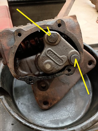

Points: 91060

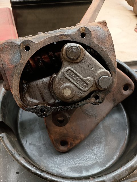

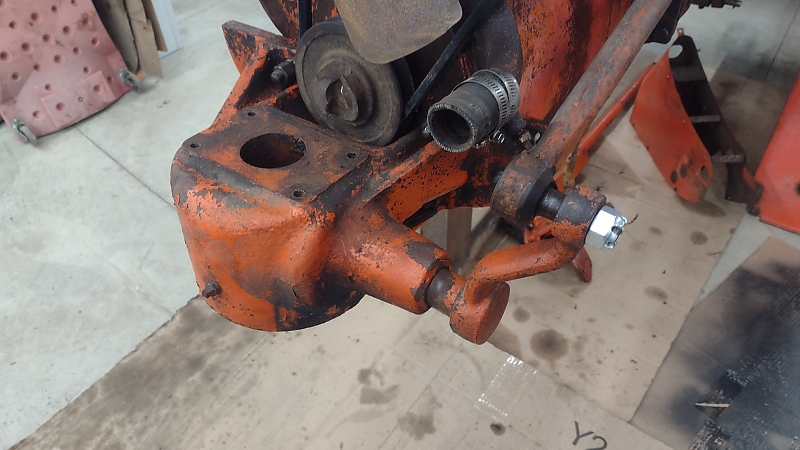

Post Options Post Options   Thanks (0) Thanks(0)   Quote steve(ill) Quote  Post ReplyReply Direct Link To This Post Posted: 26 Mar 2026 at 7:54am
these are the two "tapered pins" that will be worn.. You take the nut off the cross shaft and pull off the steering arm.... Take the cover off the back side of the gear box and push the CROSS SHAFT out of the hole.. look at the inner side of these two pins.. New pins can be made on a simple lathe... someone probably sells them, but i have not looked..
Edited by steve(ill) - 26 Mar 2026 at 7:57am

DCAC View Drop Down
Joined: 20 Oct 2018
Location: east central SD
Points: 529
Post Options Post Options   Thanks (0) Thanks(0)   Quote DCAC Quote  Post ReplyReply Direct Link To This Post Posted: 26 Mar 2026 at 9:01pm
Steve, Chris, Gary and Dan, Thanks a bunch for all the advice and pictures, that all helps out a great deal!  The pawl in the pic is similar to the one on the Yesterday's Tractors post.  Hopefully it's a simple adjustment and it will be improved.  The steering arm joints seem pretty good; the worst play is in the Ross box right now.  Thanks again to all of you!

Checked my CA steering and it looks like 90% of the slop is in the ross steering box.  I could not quite see for sure.  Is the adjustment screw accessible through one of those toolbox cutouts?  Or do I have to remove the fuel tank again?

Post Options Post Options   Thanks (1) Thanks(1)   Quote CA13414 Quote  Post ReplyReply Direct Link To This Post Posted: 08 Apr 2026 at 1:14pm
It is accessible through one of the holes in the toolbox. It has a locking nut on it, then can be adjusted with a flat screwdriver.
