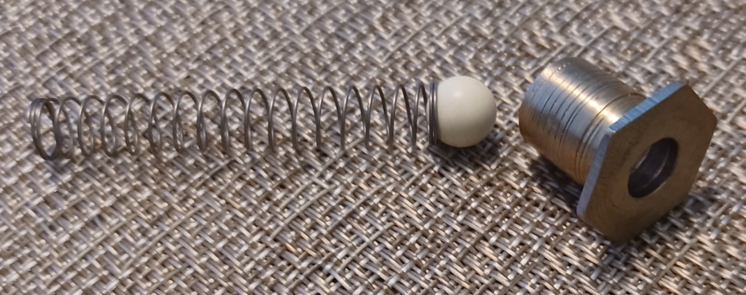

I don't believe it should be necessary, but I've explored some options to make a suitable check valve out of commodity fittings.  There are also some serrated press fit ball plunger type housings that might be suitable for conversion but they all seem to massively block flow (like that in the pic above would seem to).  It seems like it might be better to increase the inlet hole size to 5/8" and design around that increased inlet size to maintain adequate flow through the check valve.  It would help if I knew details of the back pressure.  I don't think there is very much based upon my plugging the hole with my thumb trying to judge whether it was pumping or not.
1952 CA13092
dfwallis View Drop Down
Joined: 09 Mar 2023
Location: DFW
Points: 892
Post Options Post Options   Thanks (0) Thanks(0)   Quote dfwallis Quote  Post ReplyReply Direct Link To This Post Posted: 02 Oct 2024 at 5:48pm
Hopefully not needed, but I've created a small press fit check valve that I can use for testing purposes if the repair shop does not find an issue with the pump.  I do know that the control valve spring needs replacing, he's doing that.  Otherwise, the pump looks like new internally as far as I could see.  This will probably need additional minor machining.  I left it slightly oversized because I don't have the exact hole size.  I measured it with a caliper but just in case, I'll finish it up there.  Of course I don't know the correct ball size, "cracking pressure", whether the mod increased the inlet size, etc.  This will use an 11/32" ball (not the plastic one in the pic) which is about the largest I could conveniently fit in the housing and allow adequate flow.  There is a body depression near the top that I might use for a seal if needed.  I'll also probably need a cage to capture the spring and ball.
Edited by dfwallis - 02 Oct 2024 at 6:13pm
