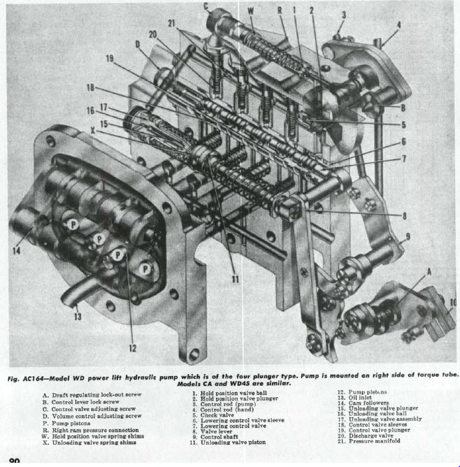

Does anyone know if there is an access port pre-control valve on the CA hydraulic pump? Some pictures seem to show a plugged outlet, but none show it clearly that I can find and it's hard for me to interpret the images that I can find. And of course I can't tell if it's before or after the control valve.

What are you trying to do? All oil goes into hold position valve and out. MACK

What are you attempting to do ????? If you removed the HOLD valve assembly from the top of the hydraulic pump's main body, you'd see one hole. That hole is where the pressurized oil comes from and returns to, WHEN you activate the lift/lower lever on the pump that turns the pump ON or shuts it OFF.

I dont see a good way to do that with just the factory pump... The pump puts out oil CONSTANTLY...back to sump at no pressure. When you stroke the valve, it shuts off the sump drain and puts PRESSURE oil to the output port (hose)... dont see a good way to get INBETWEEN that..
