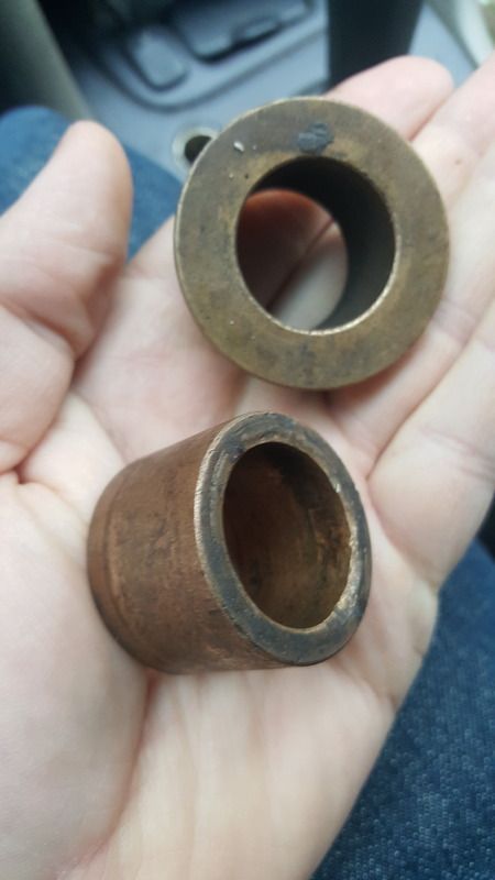

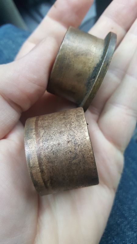

I am now starting to put the hand clutch back together but I can not recall which is the correct pilot bushing (took it apart a few years ago). I have 2 different bushing with the same OD and ID (both fit into the bore) except one has a flange on it.
Which one is the correct bushing?

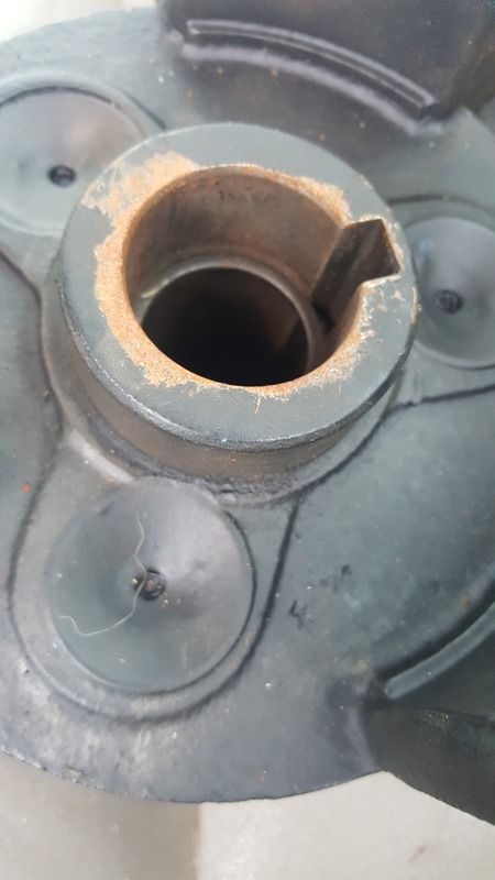

here is the bore in handclutch where the bushing goes

The one without the flange is what I always see in the hand clutches.    Rick

Rick, I really appreciate you input! I'll follow suit and use that one to.
