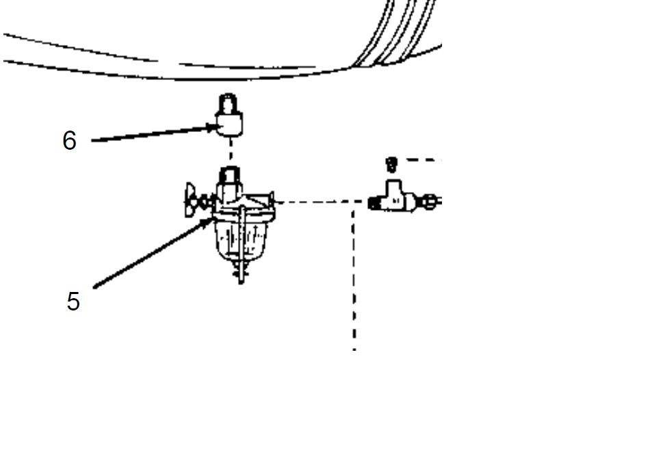

I have a 1948 C with a later CA fuel tank (starter bump).
I have a few questions about the set up. I attach a picture from CA parts book.
My extension stub  (item#6) is hex shaped for a wrench, others I see in net pictures are round, needing a pipe wrench to screw in. Parts book picture looks round. Is mine original or a kludge?
When I painted it years ago, I tried to unscrew it, but it was tight. I gave up, didn't want to rip it off the tank. Is that boss welded on, brazed or soldered?  Not that I want to take it off, just want to know. Has anyone had one broken off?
The sediment bowl, Allis didn't use a mesh strainer tube on the end of the sediment bowl assy., correct? Any reason to add one?  Which brings me back to the extension tube, does anyone know the clear through diameter in it?
My shut off valve is leaking I will be taking it off to repair or replace. The bowl assembly was original to the C, not the replacement CA tank.
Thanks for any advice.

Mine is a hex on my CA.

The earlier extensions were round, later were hex.  I don't know exactly what year - would have to do some research to say for sure, but think in the late 1940s.
