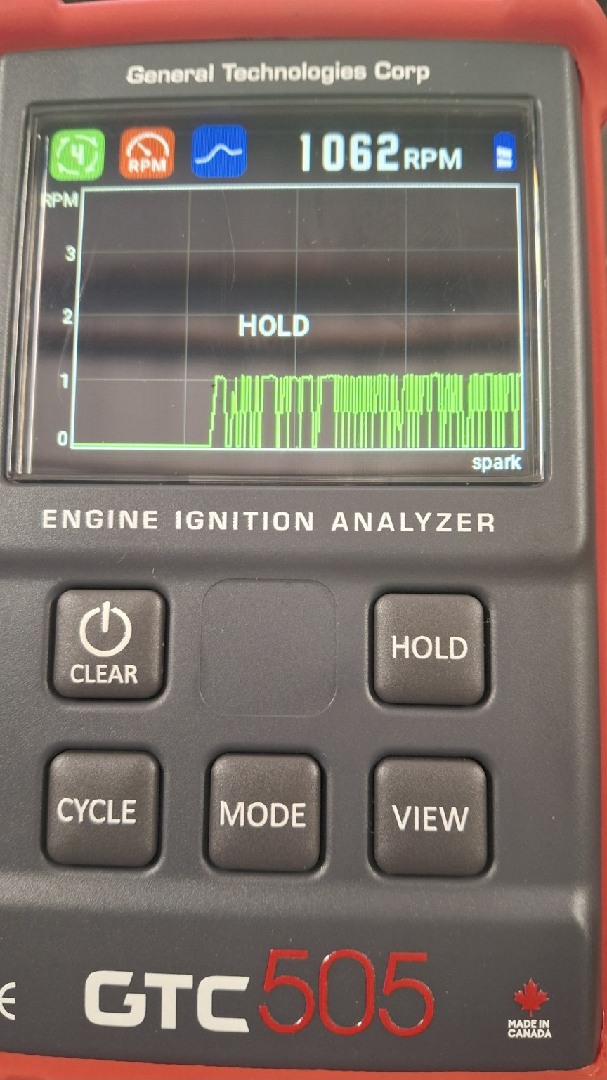

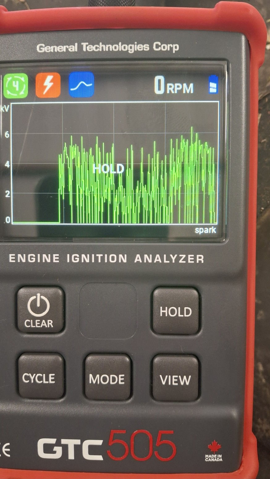

When idling very slow it sounds almost like the key was switched off momentarily, but the voltage to the coil or signal to/from the points never shows any hint of a dropout on a voltmeter. Wish I had an oscope to look closer. Oh boy, a new toy...hard to get my tek 536 on the plane.
Edited by dfwallis - 28 Jun 2025 at 12:04pm

Originally posted by dfwallis dfwallis wrote:
When idling very slow it sounds almost like the key was switched off momentarily...
I have actually had this happen with poor contacts inside the switch
...but the voltage to the coil or signal to/from the points never shows any hint of a dropout on a voltmeter. Wish I had an oscope to look closer. Oh boy, a new toy...hard to get my tek 536 on the plane.
My Fluke 88 meter will record Min/Max readings and would pick up a momentary disconnect; just watching the meter probably would not be noticeable though. I do have an oscilloscope too Smile

I've ordered a new portable oscope that should allow me to actually correlate the points signal with the resulting spark of the secondary, Ch1 vs Ch2 (10000x reduction probe).
Edited by dfwallis - 29 Jun 2025 at 8:56pm

Six videos have been uploaded to https://www.youtube.com/@OrangeAcres-h2k
These are under the playlist "misfire analysis".  They will go public around midnight 1 July (CST).

The videos are now live.  I need to search for one more that shows the long duration recording better.  I changed one of the settings and never got it back to the same view :(
I also found some fire resistant fiberglass braid tubing that should help me better isolate the spark plug wires and eliminate the interference between plug wires.  25KV breakdown voltage.  Hopefully it will allow a more accurate view of what's happening.  I received my new oscope/dmm/signal generator and ignition probe.  It's quite nice for the price.
Edit:  I only find stills of the long duration recording showing the apparent dropouts, no video.

I've not found many good clean signal views due to wire proximity interference.  These two images are the best I could locate.  Unfortunately they are before the distributor rebuild:
Both cylinder 4.  These are both before the distributor rebuild, the signals are now much more consistent, but still show these "apparent" dropouts.  All cylinders look similar to each other if you get rid of the proximity interference:
RPM (pulse count):
Every one of those "wide" pulses seems to correlate with a misfire.  These appear on all 4 cylinders.  It also correlates with the meter having difficulty reading the correct RPM rate (cause or symptom of the instrumentation??).
Voltage (Again, before the dist rebuild, it's now much more consistently around 6KV):
I selected "hold" during a period when it couldn't read the RPM rate.
