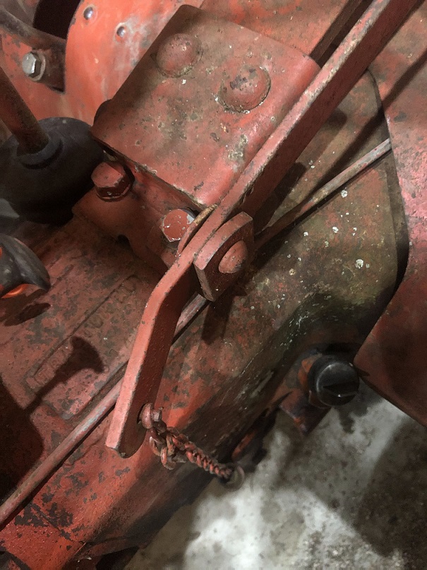

I have a CA  with traction booster hitch and need to know where the release lever and chain mount for the draw bar realease. I bought the tractor in pieces.

Here's a photo:
The mounting bracket is a right angle that is secured by the bolt to the left of the arm and bracket. The arm is attached to the bracket using a large rivet.
HTH.
