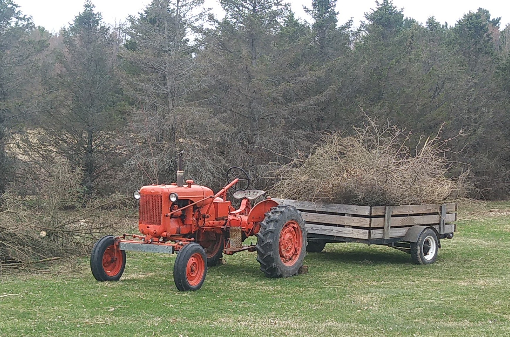

Just be for calling it a night yesterday taking care of this project
I was going to take one more load out to add to the burn pile. " Mr Tractor" was idling and just shut off. Done. No weird noises or anything. He does this when he runs out of gas (doesn't spit and sputter...just quits). Didn't think too much of it and checked the gas. Plenty in there.
So I go to restart...nothing. Not a partial turn over, no gas rushing out of carb (does this if the battery is real low but not enough to do much else), not a click or a tick, nothing.
Have suspected over the last year the charging system only works partially. Often have to put battery on charger (though didn't have to all winter...go figure!).
So pulled battery and put on charger for the night and went to bed. Also ordered new wiring and tune up stuff from Steve in NJ which I've wanted to do since I got the tractor before brushing my teeth.
This morning put battery back in. Tried to start...still nothing except the sound of me pushing the starter rod.
Went through the wiring system. Found no bare wires but the regular few that I had wrapped with electrical tape and some tape had slipped off-reinsulated .Cleaned battery connections, found a loose nut on the generator field wire terminal- tightened it, found a loose wire on starter switch- tightened it, and then tried to start up.
Fired right off.
Here's what was different though: my instrument panel ammeter was showing no charge. Just sat at zero. It always did show a charge at low, middle, and high be for the issue yesterday. Now at middle light setting and high charge setting it is showing a discharge of around 10.
Did some more work on the dead/dying wind break today with Mr Tractor and took the battery out be for calling it a day.
Need to call Steve in NJ about my order and may pick his brain some when I do.
Thoughts on what's going on with the discharge and not showing a charge anymore?
Thanks much.
