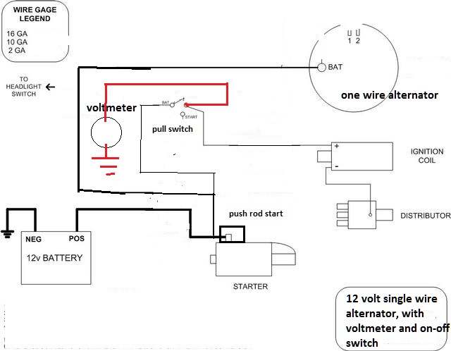

Hey guys I put a new Denso one wire alternator new 12v battery new wiring new voltmeter new internal resistor coil tractor runs perfect does not show a charge I unhooked the wire coming out of the alternator and just ran motor wide-open and tested the alternator and nothings coming out is that normal with nothing hooked to it? Steve please I need a simple diagram. I have push/pull sw, volt meter, and pull rod to starter. Help please😂🤔. Thanks!
Blue Skies and Tail Winds
                          Dana
Points: 88005
Post Options Post Options   Thanks (0) Thanks(0)   Quote steve(ill) Quote  Post ReplyReply Direct Link To This Post Posted: 13 Jan 2023 at 8:53pm
one wire alternator should have one BIG wire ( maybe  8- 10 gauge) running from the BIG terminal to the Battery + terminal, or the other end of the + terminal at your starter lug..... Should be HOT all the time.. You need POWER to the alternator, and adequate RPM to get the alternator to Charge... If you have a volt meter, see that you have 12v at the alternator...
you have a VOLT METER, so it goes in parallel with the alternator, not in series..  will get a simple picture.
Points: 88005
Post Options Post Options   Thanks (0) Thanks(0)   Quote steve(ill) Quote  Post ReplyReply Direct Link To This Post Posted: 13 Jan 2023 at 9:07pm
...here is a basic drawing..
--BIG wire from the alternator straight to the battery + or starter + cable
--you have some type of ON- OFF switch to put power to the coil
--the voltmeter gets it power from the OUTPUT of the switch
--the other side of the volt meter is grounded or goes to the - battery post
--the ON-OFF switch has one HOT wire input that comes from the + bat or + starter cable
--you should read 12 volts at the starter lug and the alternator lug all the time, engine off
Points: 88005
Post Options Post Options   Thanks (0) Thanks(0)   Quote steve(ill) Quote  Post ReplyReply Direct Link To This Post Posted: 13 Jan 2023 at 9:10pm
If you have a MAG then your "OFF" switch will ground the mag... You still need an ON or POWER switch that puts power to the volt meter .... ?? right ?
