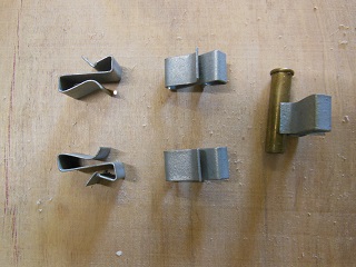

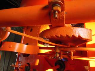

"Throttle lever will not stay put on the rack of teeth mounted to the steering column, had a bungee cord on it when I got it."
I have same problem with the throttle lever on my CA.  A new spring did not help.  Eventually I'll disassemble and work on the teeth and lever notch as suggested above.
For a short-term fix I found some metal brackets in my junk drawer that fit the lever and notches and has worked well - see pictures below.

@Dale (Stonelick); Ingenious! Any idea what those brackets were for originally? Thanks.

I pulled them off two pieces of thin plywood - the clips joined them together in an overlapping manner.  Not sure of the purpose or if that was the original function of the clips.

loooks like the little metal peices you get to hang christmas lights
