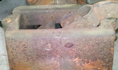

Hello! I am trying to replace the brake bands on my old C, unfortunately the pin is not wanting to come loose from the axle tube. I have been soaking it with Blaster. I am open to ideas and am wondering what works well. Air hammer? Heat? Drill :(? I appreciate your replies!

If a big hammer isn't working you can try some heat. On my C, I ended up drilling one of them out because heat and a big hammer didn't work.

BFH and some HEAT!!!

Use a drift on the end of the pins as seen in the picture, along with more Blaster.

This is the way I took them out until I found using the air hammer punch was much faster.  With the air hammer it is a few minute job without blaster.

I run under the presumption that if a little is good, then a lot is better when it comes to penetrating oil andI also try more than 1 formulation.  I usually hit something with some Kroil, then some PB and then some JB80.  Soak it good from the inside of the housing and outside and soak both pins at the same time, they both need to come out.  Also soak around where the pin goes thru the brake band because it needs to move thru that also.  If it runs down inside or outside, no big deal, it will clean up.

I remember when I restored "Alice" my B. One final was full of grain, and the other had a mouse condo in it. And, it didn't smell good either!!  Whoa!  I found that heating up around the pin, and spraying your favorite penatrating oil around it and the heat drawing the oil in allowed me to drive the pins out quite a bit easier. I then ran the pins on my wire wheel grinder and cleaned them off. I then took a round wire brush that fit in the pin hole and chucked it up in the drill and cleaned the pin bore out. On re-assembly, I used a heavy coat of Anti-seize on the pins and in the bores. This way if I ever have to service the brakes again, I should be able to get things apart without to much trouble. I did the same thing to the adjusting bolts/jam nuts. That's an area where "heavy on the Anti-seize" isn't a bad thing. Its been over 10 years now since I did that. Man, where does the time go....!

Thank you very much for all the help. I tried heating it with a propane torch then MAP gas... and having at it with the hand sledge, no dice. Ended up cutting out the middle with a stick welder as finding someone around here with a O A torch turned out to be difficult. once the center was cut out a 16 lb sledge and a few punches (bent 2) got the job done... so anyone have extra pins they would be willing to part with, or know where I can get them?

I did a brake job on a 39 B Today.  1/2 way.  Still need to put everything back together with new bands I had for 15 years.   Soaked the 4 pins overnight with PB.  Today I would get them out the easy way by using my sons air hammer .    The only way to go in my book.
     Getting the old bands out when the hinge is rusted solid and rock hard grease or oil and dirt needs cleaned out of the way.

Excellent point. Hopefully the "C" clips that keep the brake band pins centered in the housing were removed prior to driving out the pins. If its all rusted and dirty inside the housing they can be hard to spot.

YEP......... you can smack it 300 times with a 5 pound hammer....... or use an air impact that is pounding 300 times per minute and poke them right out....... and some penetrant never hurts.
