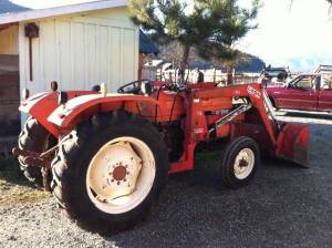

Hey guys,
I am looking to buy a AC 5040 2WD with a loader and brush hog from a guy for $3,300.  It looks to be in decent shape, but it has 2680 hrs on it, which seems high to me.  Is that too many hours for this model or would it be a decent purchase?  Would I need to rebuild the motor soon?  It will be for my 10 acre 'hobby' farm, so it will not get a ton of use, but I don't want to be fixing it every time I want to use it.  Any thoughts?
Thanks!

I paid $3000 for my 5040, it came with a 5' rotary mower, 20 disc harrow, 6' scrape blade, and a boom pole. It dosen't look near as good as the one in your pic. All I have done to it is changed oil and filters and run it. $3300 for tractor w/loader and mower sounds like a deal to me.

2860 Hours are high to you??  The tractor is over 30 years old, which means the tractor was used less than 100 hours a year.  It is not uncommon to see 10 year old tractors with over 5000 hours now.
The picture you posted looks as if the tractor is really clean.  But as others have said, I would much rather have my D17 (8200 hours and still going strong).
