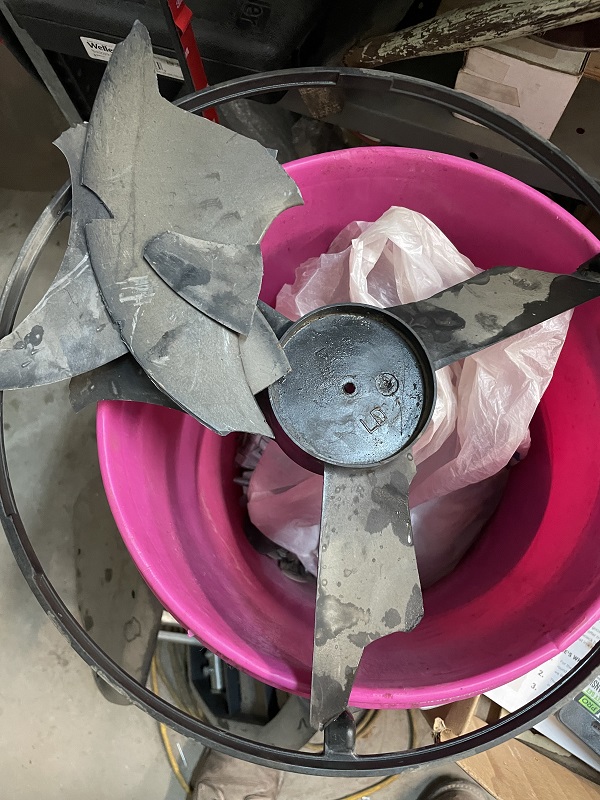

All that running around got completed, AC has been swapped on the LQ trailer last weekend and is functioning well.  Have a Roof vent to change to a Fan type for the Bathroom area, old one has a fan but is cooked.  The PTHP or PTAC Heat Pump we had installed in the Shop space decide was also time to fail, received error code E9 which translates to High Condenser Pressure, once got pulled from wall was obvious, plastic fan blade had self destructed.  New fan is installed on motor and motor is OK now to reset the Enclosure insulation, clean some and reinstall the whole mess.
