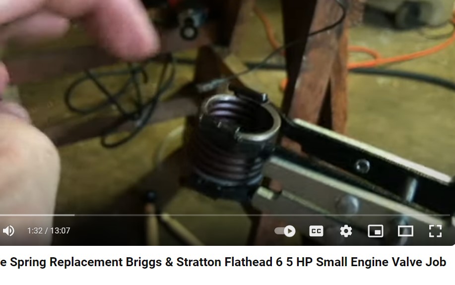

Taking an old engine apart.. Intake valves have a seal/ plate that the spring sets on.. Both exhast springs were setting on the aluminum housing.. No steel plate / washer below the spring... Is that normal ?

No close ups of 18 HP on You Tube... but i did see a 6.5 HP that does NOT have the backup plate.. Guess i am not use to seeing that.. Have done very few small motors and its been 15 years since the last one...

looking  at  You Tube videos and this engine is 20 years old.... None seem to have a plate under the spring on the FLAT HEAD engines.. There is NO valve guide so nothing to center the washer / plate.. Guide is just a drilled hole thru the aluminum housing. Spring just sets on the aluminum case...
Engine ran low on oil and one rod stuck to crank and broke.. No other damage. I polished the crank and looks good. Bought a "kit" on e-bay with pistons , rings , rods, wrist pin, valves, seals and gaskets for $300.  Almost back together today... I could probably get by with a rod , gaskets and seals... but thought for the old girl i would go ahead and get new pistons / rings / heavy rods and new valves.. Took very little to lap the valves, but had to grind about 25 thousands off the stem of each to get the valve clearance... typical..

HUD... i miss spoke.. I got NEW valves in the kit.. Old seats were in good shape.. There are no "valve adjusters" on the L head engine.. You grind the end of the stems to get the proper clearance you want. The valves come EXTRA LONG so you can grind to fit.. Once i got 8 thou on the intakes and 12 thou on the exhaust, i lapped the new valves to the old seat.. I dont think i spent 1 minute on each valve to get a nice seat.

It's been almost 40yrs since I worked on one of those, but I recall a plate under those springs.  IIRC it had something to do with how the valve was to rotate... I THINK that without it, the intake valve wouldn't rotate right... exhaust didn't have any problems with it, just the intakes...

Intake just has a top spring cover with elongated hole in it.. SNAPS on over the valve stem.. Exhaust valve has a rotater on top with standard KEEPERS in it to retain the valve.. No bottoms on the springs. They set right on the aluminum housing.. there is no valve guide protrusion to hold any plate in place.
