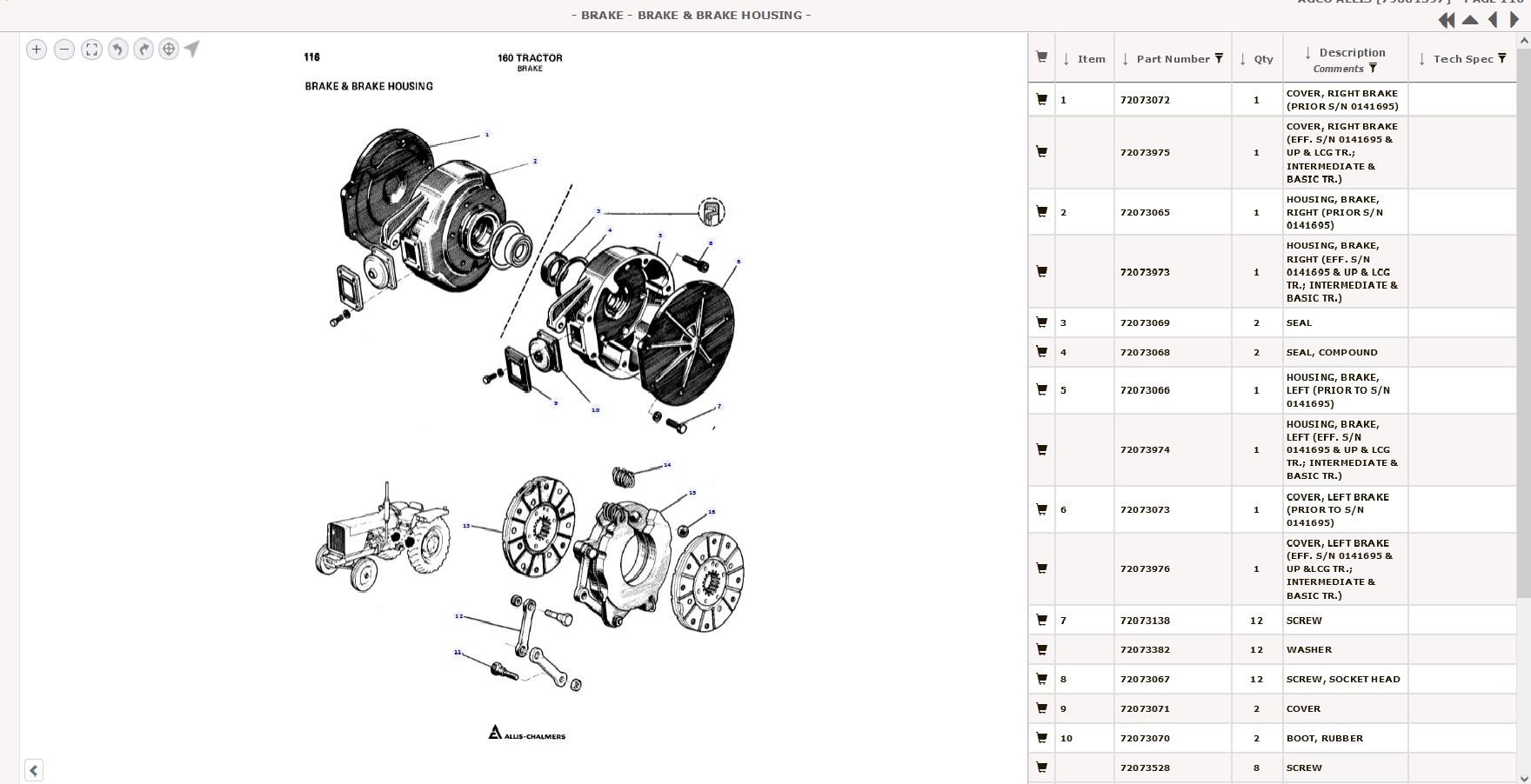

Problem with my 160.
My left brake is locked. I can't move.
I tried rocking back and forth. See picture, it is a disc
type, in external housing, maybe similar to the 190.

Loosen the adjuster as loose as it can be and then try rocking it back and forth. Clean up everything inside with new return springs and antiseize on all the balls and pockets.

I did my 190XT a few years ago and usually the ramps become really dry, the balls tend to slide instead of rolling and they wear a flat spot on the balls. Thankfully mine where just dry. Cleaned up all the ramps, never seize on the ramp and balls and they have worked great. Be thankful those puppies are on the outside instead of inside the of the housing. Not bad to work on at all, just pull the cover off slowly and inspect everything before you tear them apart.
