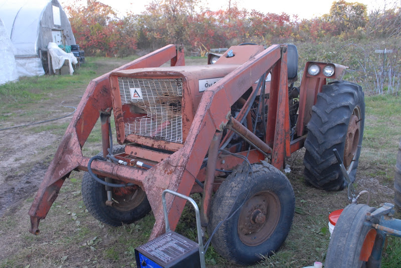

Here are some pictures, she's not looking too pretty right now but I have all Winter to work on that. Right now I just want to get her running and focus on any mechanical issues. I don't have pictures of the buckets, they're elsewhere right now and I'm betting you all know what they look like anyway... :)

She looks like she's had a rough go at it. Good luck with her and keep us posted.
