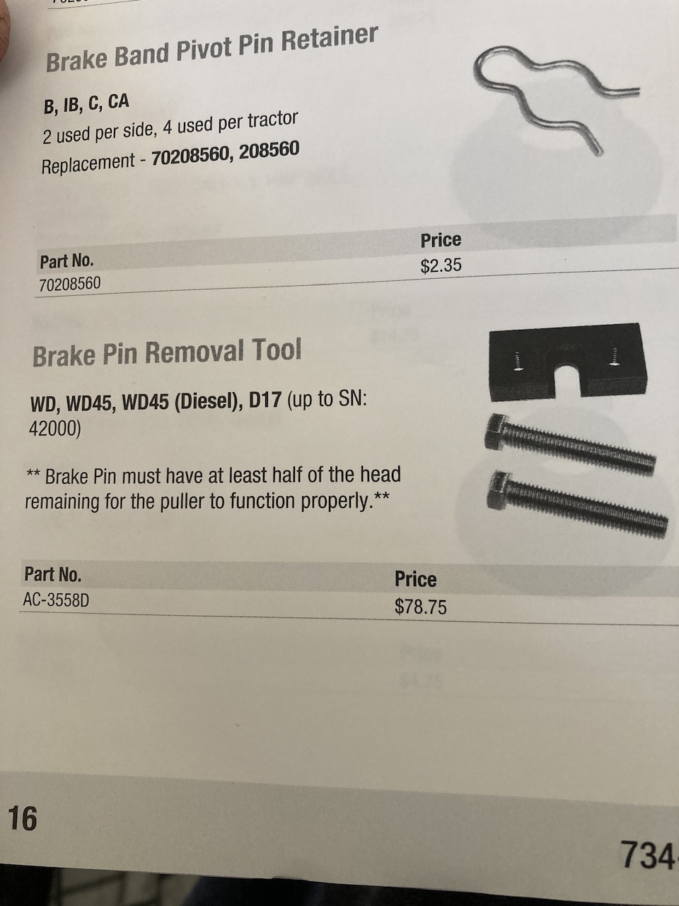

There is a tool for that job, I will probably need to buy one too. This is from the DJS tractor parts catalog, but they are available from just about anywhere that deals in allis stuff

If you’ve messed up the end of the pin, the tool probably wont help. You could get an all-thread coupler (a nut thats about 3-4 times longer than a standard nut) and weld it to the outside end of brake pin and use a slide hammer (if there’s room) or thread some all-thread into it, then slide a large deep well socket over the all-thread and some washers and a nut. Crank down on the nut to pull pin out. Probably heat the pin again first….

Those tools have about a 25% success rate, rest of the time they just pull the head off the pin. I have cut the pins out on a couple but a better approach is to drill and tap them and fashion a puller out of a short length of pipe or something. Pins will still be usable afterword. Think I tapped them 1/2-20.

I cut the pin out the new pin is only 30.00 tool is a lot more only takes 15 mins to cut it out
