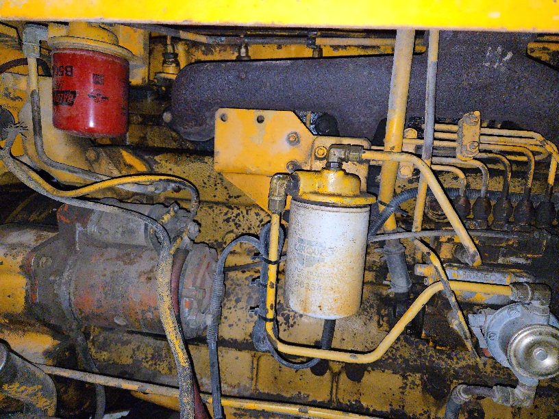

Hey!  That picture looks familiar!
Points: 8971
Post Options Post Options   Thanks (0) Thanks(0)   Quote SteveM C/IL Quote  Post ReplyReply Direct Link To This Post Posted: 02 Feb 2026 at 8:03pm
Told ya I was learning....more work to grab someone's pic off a text and get it here.
Points: 8971
Post Options Post Options   Thanks (0) Thanks(0)   Quote SteveM C/IL Quote  Post ReplyReply Direct Link To This Post Posted: 02 Feb 2026 at 8:12pm
This mine. You can see where heater is. The orange one belongs to another forum member. My fuel filter blocks port his uses for heater.
Points: 8971
Post Options Post Options   Thanks (0) Thanks(0)   Quote SteveM C/IL Quote  Post ReplyReply Direct Link To This Post Posted: 02 Feb 2026 at 8:15pm
Mine
Points: 8971
Post Options Post Options   Thanks (0) Thanks(0)   Quote SteveM C/IL Quote  Post ReplyReply Direct Link To This Post Posted: 02 Feb 2026 at 8:23pm
Easiest plan B is put a tank heater on but I don't like where it needs positioned Drain plug on side of block up to tstat hsg. I may pull that filter etc off to see what.

I had to look at my tractor engine, whoever did the swap moved the filter housing down, it also has a dual filter. I will try to link the picture so you can zoom in on it.
https://photos.app.goo.gl/upuHsvhmEyBiamBh9
It looks like that would make it a lot easier to put the heater in, and it would be more centered in the block.

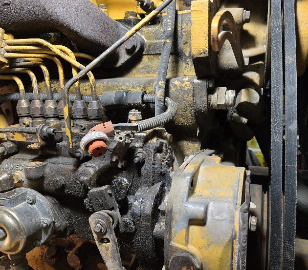

TedN...could you get a pic of the other side? I see your engine has that water manifold going around the back of head too headed to oil cooler? My water pump is different than a tractor but application list loader and Gleaner M&L 301's as same.

https://photos.app.goo.gl/GPif8dscg9Zu2VjU6
I think this is the correct link.

Yes Ted. That's what I was after. On my loader the rear cooler is as yours and cools the oil. The cooler connected to the water pump is for the trans but I don't see any connections or plumbing for such. Mine has two 1/2 in npt connectors welded on the side that hoses hook to.

The combine used a tube in place of the trans oil cooler used on the loaders
Points: 8971
Post Options Post Options   Thanks (0) Thanks(0)   Quote SteveM C/IL Quote  Post ReplyReply Direct Link To This Post Posted: 03 Feb 2026 at 10:30pm
Well that makes sense!
