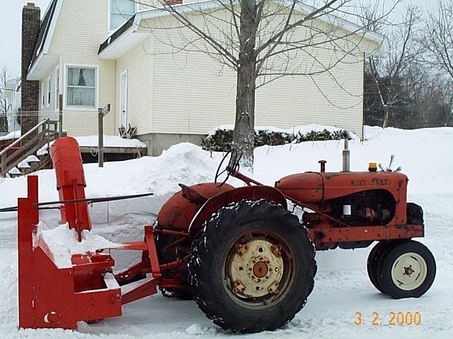

I used this setup for abt 13 years ..2 sacks of hard crete on front..no chains...did 10 driveways in neighborhood under contract with it. Loaded tires...if slip a bit just raise blower a tad ..second pass clean it up. We averaged 120 to 200 inches of snow those years too. Those bank cutters were always working the last month of winter..often snow falling over top of blower even.
I've posted this before, I know but  the question was asked.

Please forgive me for this dumb question but do you back in to the snow with a snow blower on a tractor? I've never laid eyes on one. I was just looking at the pics and wondered.  We have enough snow to use one this time but it's so stiff my bronco just rides on top.

Thad .. not a dumb question ..mine fits on the back of a three point tractor .. 6060 used to work .. on it when i had it but its more fun in a cab tractor .. The county has a 10 foot mounted on the front of an Oskosh truck ..

Yup.You gotta turn sideways and drive backwards.You learn to pay attention to wind direction and chute direction but I still prefer it to a blade or bucket.It's MUCH quicker and you don't have huge piles next to your drive to catch the next snow storm.The down side is it throws rocks (or anything else) where ever you aim it.The wife don't like rocks in the yard....oh well!
