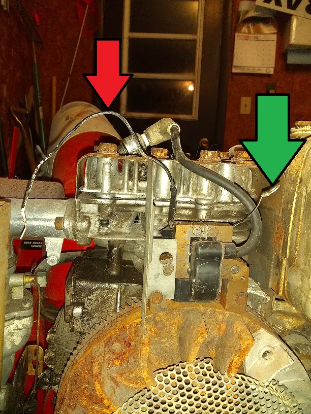

Thanks for the info AC720Man! Hopefully my engines don't need a lot of work like you described with yours. I pulled the Tracker 8 into the garage and started checking things out. My compression test showed 62psi. I don't have any spark. The spark plug is a Champion J19LM. The paper work for the last engine place that looked at it said they replaced the breaker and condenser. I've included a picture of what else I've found when I pulled the flywheel cover off.
I have a wire (Green Arrow) that comes off the mag that is not attached to anything. I also have a wire (Red Arrow) that comes out from behind the flywheel not attached to anything. I believe the wire with the "Red Arrow" goes into the crank case...? Would have to pull the flywheel to verify. I'm lost on what both wires should be attached too. If anyone has a manual for the Tracker 8 snow blower or the manual for the Biggs engine I would be interested in purchasing one.

Post Options Post Options   Thanks (0) Thanks(0)   Quote AC720Man Quote  Post ReplyReply Direct Link To This Post Posted: 08 Sep 2020 at 9:09pm
The wire under the red arrow goes to the kill switch on the throttle plate. As you move the throttle to idle, you should see a male spade connector that the female connector should slide on. As you move the throttle more it will eventually touch the metal of the spade connector which grounds the coil to kill the engine.
The green arrow wire goes under one of the coil mounting bolts.
Of course this is based on if this is the correct coil for this engine....if it has the throttle plate that I described.

Post Options Post Options   Thanks (0) Thanks(0)   Quote AC7040 Quote  Post ReplyReply Direct Link To This Post Posted: 08 Sep 2020 at 9:33pm
Haha I been there before! Old 2 cycle Echo trimmer gave me quite a jolt! K, I'll go ahead and connect the wires as you described. I know it's not saying much but the mag looks very similar to the mag I removed because of the mouse chewed wire. Thanks for the help!

Post Options Post Options   Thanks (0) Thanks(0)   Quote AC720Man Quote  Post ReplyReply Direct Link To This Post Posted: 09 Sep 2020 at 8:44pm
My SnoBee has the kill wire attached by a spring clip which is the other way it can be attached.

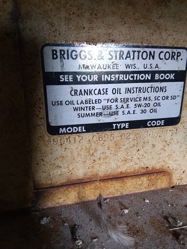

Did you find those wires not connected when it came back from the shop? If so, I would ask for my money to be refunded! Best thing to start with is get the model number, type, serial number from your engine. It’s stamped on the engine cowl or on the engine tin. With those numbers you can order the parts you need. Like any other engine, coils, points, condensers come in different types. The correct ones are required to make it run. Looking at your picture, there appears to be a lot of rust around the flywheel. Since you need to remove the coil anyway to place the wire under a mounting bolt, lets clean it up. If they did in fact replace the points and condenser then the flywheel will pop off easily. Loosen the center nut that holds the flywheel onto the crankshaft. Back it off until its flush withe end of the crankshaft. A few taps with a small hammer on the nut should pop the flywheel loose. If it doesn’t pop loose, my guess would be that they didn’t replace your parts. It takes a while for the flywheel to reseat onto the crankshaft after one has been removed. Anyway, if it doesn’t come loose then you will need a 2 jaw flywheel puller. Very inexpensive at a parts store or Harbor freight. If you haven’t used one before let me know. Once its off, use fine sand paper to clean up the magnetic pickup on the flywheel facing the coil. It should shine up pretty well when your done. Take the coil and clean up all 3 pickup points on it as well. Now that the flywheel is off, remove the cover that is covering the points, does it appear that you have new points and condenser? If so, check the gap between the points and the condenser. To make it easier, spin the nut back on the crank and use it to turn the engine clockwise slowly until you see the points open up the their widest point. A match book is the correct thickness and works well. Or if you have a .016-.020 inch feeler gauge then that will be fine. Loosen the bolt holding condenser to slide it in or out to obtain the correct gap. Once you have it set, turn the engine a time or 2 and check it again. If it is still correct, put the cover back on as well as line up the key way for the flywheel and slip it back onto the crankshaft. Tighten the nut. I use a piece of card stock, post card will work also, to set the gap for the coil because it can be wrapped around the flywheel. You only need it to go a inch beyond the magnetic area of the flywheel. Turn the flywheel so the magnetic area is at the top where the coil will be mounted. Lay the card stock on top of the magnetic area, place the coil in its mounted position. It will pull itself towards the magnet of the flywheel. Insert the attaching bolts on the coil along with the wire under the green arrow from your previous picture. Tighten bolts. Turn the flywheel clockwise and the card stock should come out as you turn the flywheel. If it doesn’t just pull it out.
