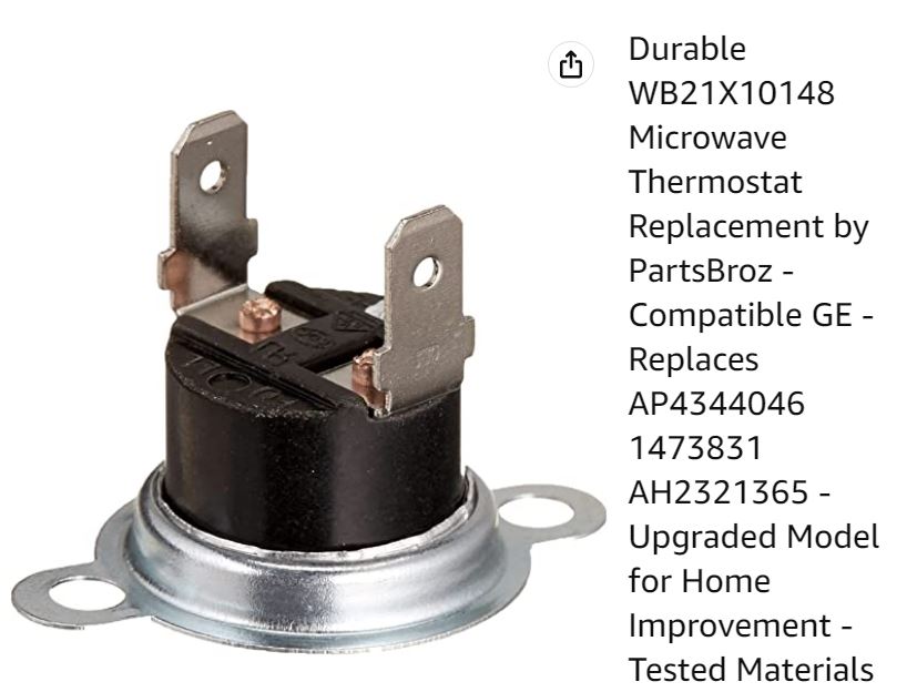

Post Options Post Options   Thanks (0) Thanks(0)   Quote steve(ill) Quote  Post ReplyReply Direct Link To This Post Posted: 14 Jan 2023 at 8:44am
I have had a couple of these temp switches crap out..They get HOT and open circuit, then will not reset... check continuity, or just jumper the two wires together to test.
