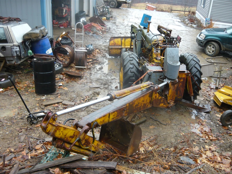

yep already fixed that problem, it had calcuim in it and the rim was rusted out at the valve stem.  drained the fluid, cleaned rim ( a bunch of times), cut out the rust and welded a plate in from another rim. new tube and put the old tire back on. (cleaned the inside the tire very well).  I also had a ford with only one tire loaded, it almost rolled over on me, but the bucket hit the garage opening and kept it from tipping.
the backhoe on the d17 is rather large and heavy. photo is before I took the tire off and fixed the rim.
