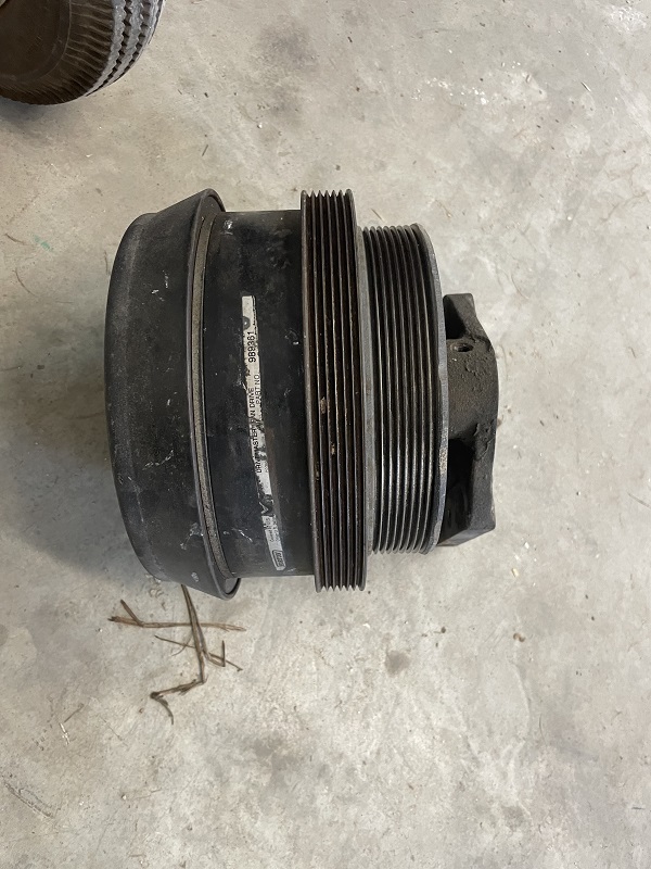

Was having Engine Fan(Air operated) issues, would Stay on, fail to disengage.  Then would partially disengage and the Bypass controls would not function.  Looked to all the controls and a air solenoid that is easily changed where thought had it, then repeated again.  Finally Caught the Hub seals in Failure, when disengaged the air to release would leak out past the Clutch Faces.
Only a Slight Blood Letting during the wrestling match, Hub is over 45 lbs, hangs of four 1.2" fasteners, Horton and common.
Had to use a Sling from over top to pull it out of engine area,  almost two hours of Joy!
