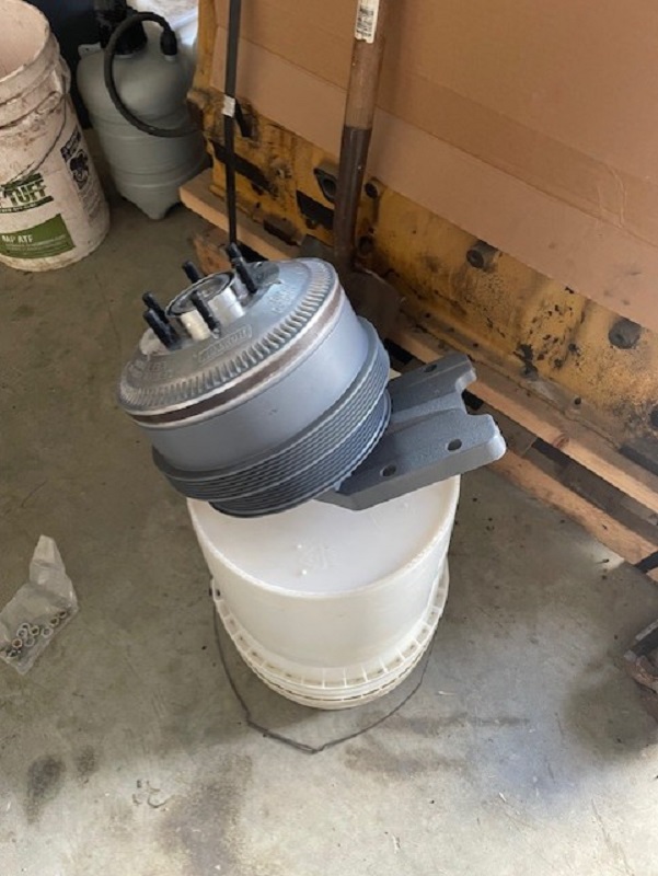

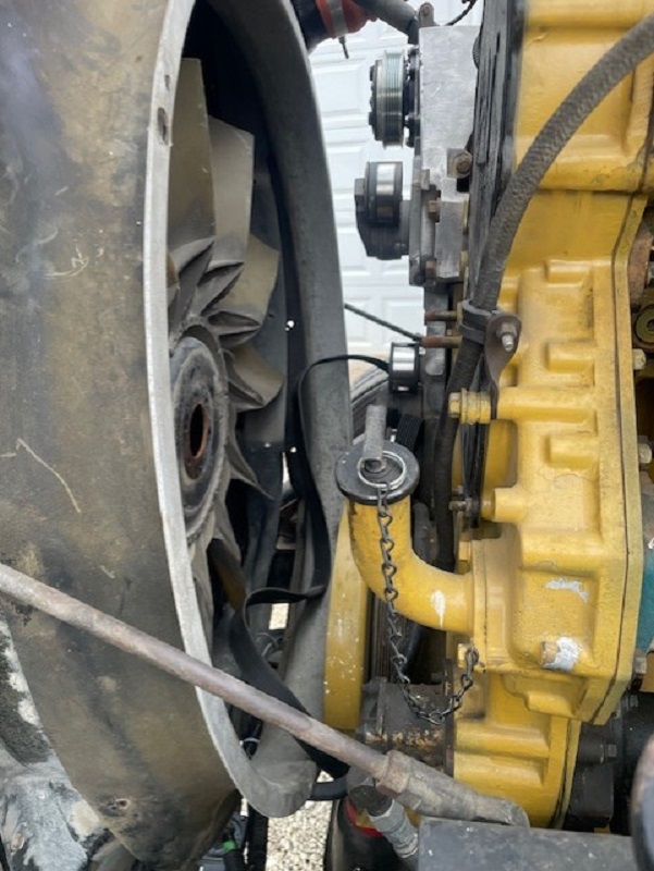

Photos, FINALLY!
Sitting on 5Gal bucket.
Prior to reinstall.  Used 1/2" Polyester Rope in a figure 8 Harness pattern, from Frontal no pulley area to rear belt region to drop in from Top.  Two Studs barely visible in Photo are lower mount hole fasteners.

Laid across Intake tubing, Used a 1/2" polyester Figure Eight Rope 'Sling' with a loop in final knot as a Handle, lowered down by hand to the Studs from Above engine nose and started nuts there, then added bolts.  About two hours calculating and removing that which needed to come off, about hour and half to reinstall.  Just under 50lbs.
