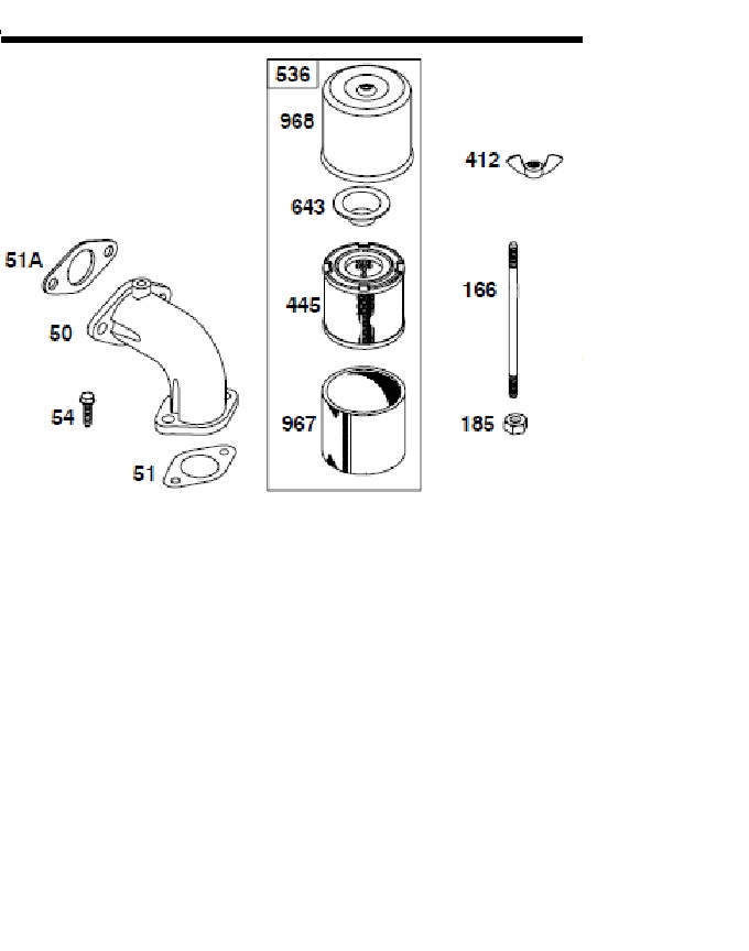

I have a B210 with a Briggs 243431 engine that has been setting about 6 years. Took the air cleaner apart and the foam element had turned to mush. Any body know where to get a paper element with a foam precleaner for this engine.

Original filter is all foam, saturated with oil.

The later Cast-Iron Briggs had paper filters. You can use a paper filter with the foam pre-filter but will need to change out your air cleaner mounting stud in the carburetor as you need the longer one.
