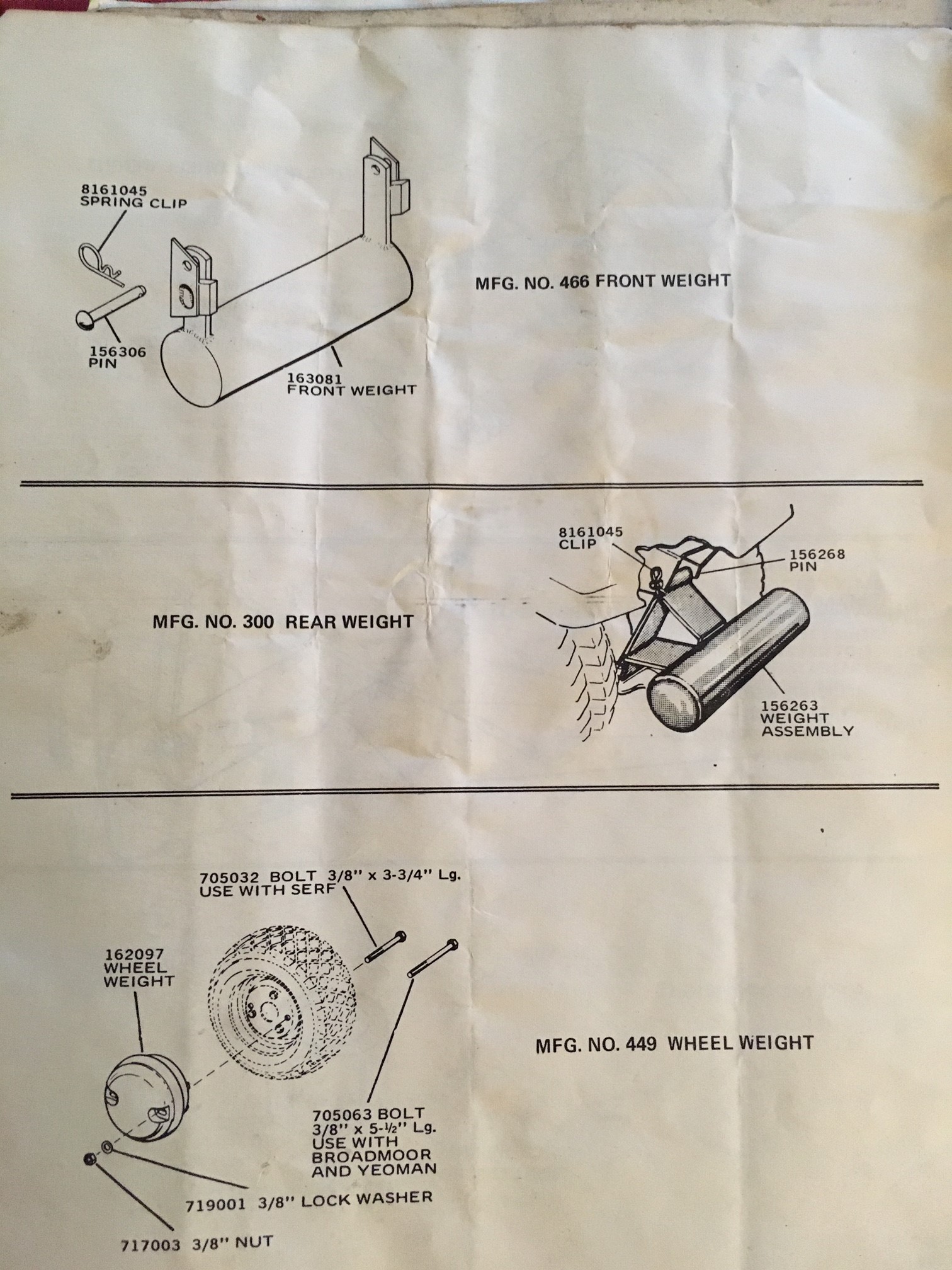

Hello everyone! I'm a new owner of a nice old B-110. I bought it specifically to till and I have an 0039 tiller (Simplicity, I think, can't find the number, but it's the one without the clutch handle.)
So, I'm tilling on a bit of an incline and I lose steering because the front end is light. What options are out there to add weight to the front end. I saw a couple front axle mounting weight bars for B-10 and big tens. Would those fit?
thanks for any advice!
Points: 8924
Post Options Post Options   Thanks (1) Thanks(1)   Quote Mikez Quote  Post ReplyReply Direct Link To This Post Posted: 11 Apr 2019 at 6:45pm
Yes they would be the same. B1-B212 would work

Welcome strengthchain,welcome to the addictions as of yesterday I am up to 14 B series lawn/garden tractors.Pick up a boat load information too.As I was reviewing it I found this section,it was offered by simplicity. I think it could be easily fabricated. were are in Pa located?uploads/18658/IMG_1159.JPG
