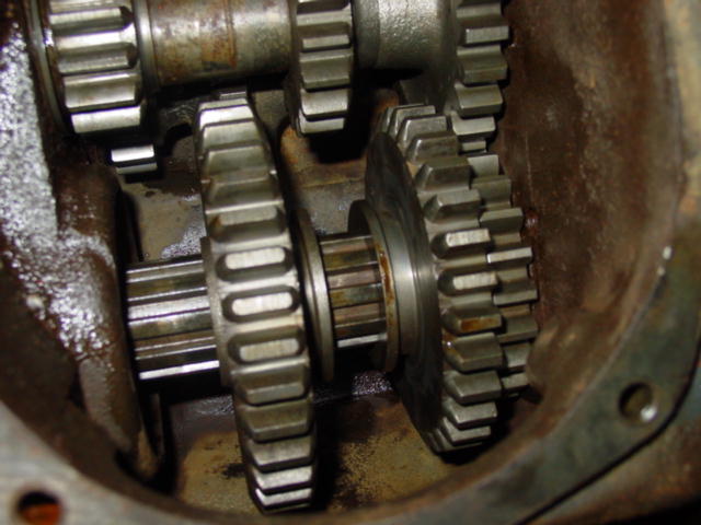

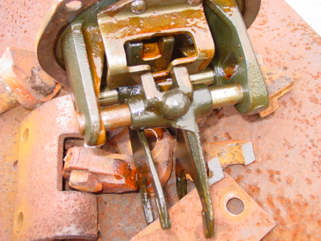

If you were going from forward to reverse repeatedly the problem most likely will be just below your shifter stick.  I would guess it would be in the side plate assembly but could just be a worn fork that let the slide gear set free from the gear that would move the tractor.
Pictures of the side plate assembly with forks and picture of the grooves the slide forks have to be in.
In the picture the gears are in the neutral position which is my guess to your problem. If it is the case you would have to examine the side plate for the cause.
