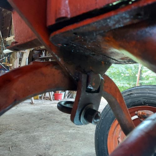

The first thing I would do is drop the pan and do an inspection of the bottom end. While you're there, clean out the oil pickup of any muck or sludge that might have accumulated  in the pan or pickup tube. If it was stuck, there was probably water in it!  An oil pan gasket is a Hell of a lot cheaper than a motor. Put new oil in it and then put it to work. At least in your mind you'll know it looks good downstairs, and it's clean inside with fresh oil as well......

Steve in NJ: I unbolted oil pan, but could not drop it.  Will need to remove WFE bolt and cut off a welded-on front tow bracket (see picture) to get the oil pan out.
