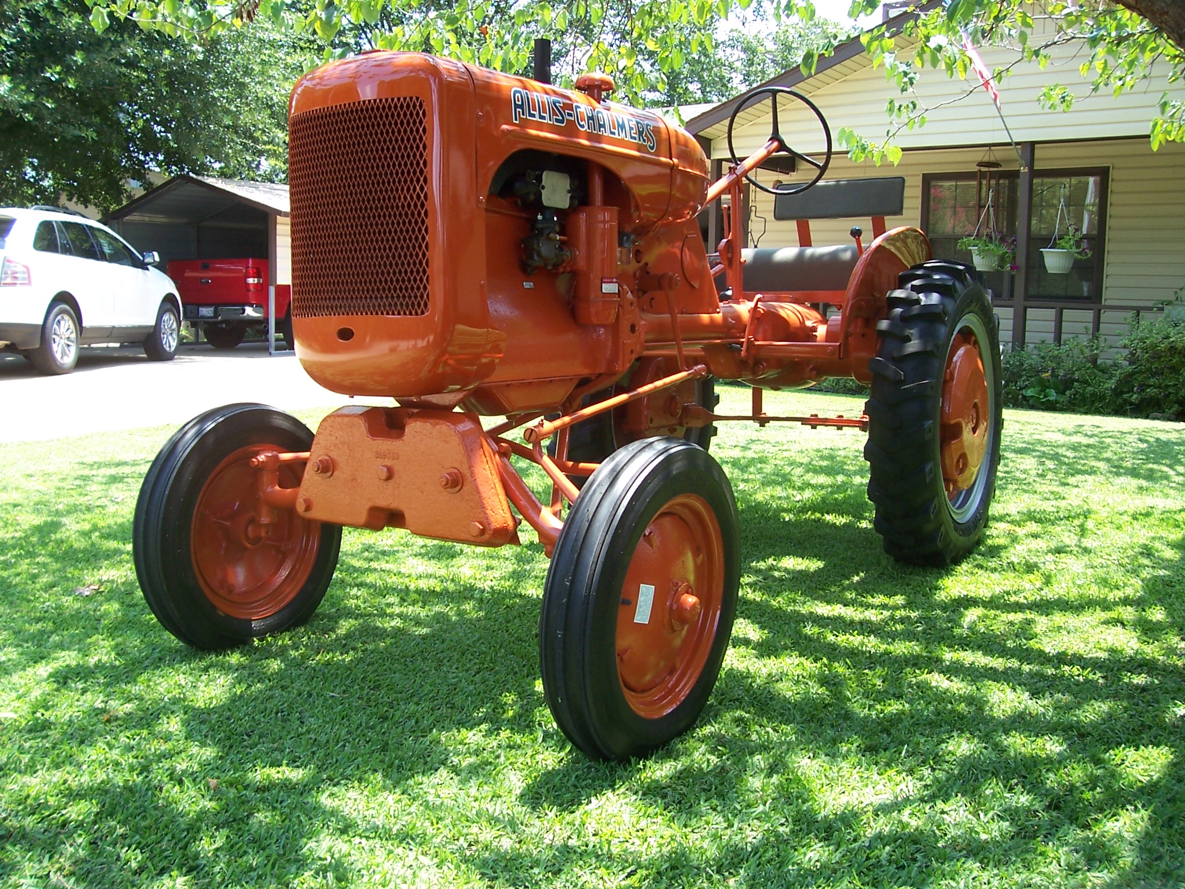

If you are interested in a fine example of a early 38 B (#751) my best friend has his up for sale. He and I restored this B with authentic early B only parts. There may not be another historically correct early B as complete as this one to be found anywhere. No expense was spared in gathering the one of a kind obsolete vintage bits and pieces to RESTORE this Early B to what it was when new.

    38B tractor B751 Restored with authentic early 1938B obsolete vintage part wherever possible.
Since this picture taken the incorrect Tri Rib Front tires have been replaced with Single Rib 5:00 15 Firestone reproductions from Miller Tire.
   Note that the 4 holes for a canvas curtain are not there on this early of a 38B. This is correct along with cast front wheels, split rim rears, fabricated clutch peddle, threaded brake lever knobs, Zenith sediment filter, Front axle weights, Pancake rear wheel weights, Canvas covered wood seat back, covered steering wheel spokes and much more. The tranny casting is different at the filler plug and correct for a Early 38 B
