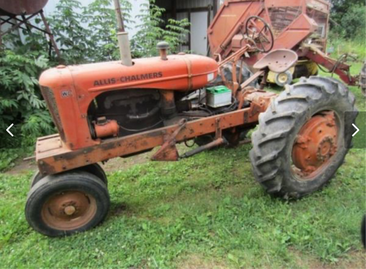

Here is the steering wheel relocator on this tractor.
Some debate years ago whether it was AC or Ford built.

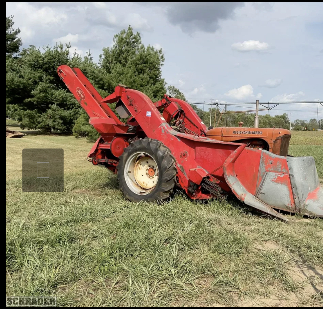

Here is another one
