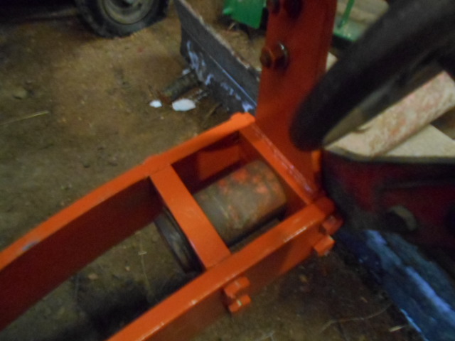

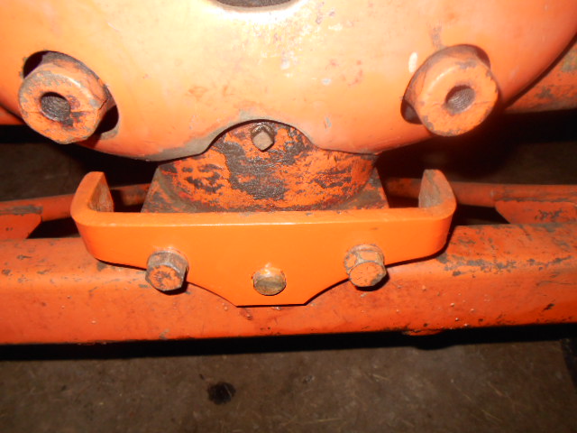

Here is a pic of the pivot blocks and the pic of my front axel pivot bracket I repaired mine but other have looked for a new part. hope this helps the bolts are 5/8 and 2" apart the big pivot hole is 2 3/4" can't  help on blade extensions. Randy

Are the bolts tapped into the block or all the way through?

Bolts are tapped into the block about 1 3/4" the block is about 1"x 3 1/2 x5"

I'm in need of a couple of those blade pivot blocks. The bolt holes are tapped. I have two blocks with snapped off bolts in them that I couldn't dig out. So I have a blade in pieces because I need replacement blocks. It's on one of my many "to-do" lists.

Does anybody in central mn have one of these blades or could send me more exact measurements of them? It looks like the back block has a flat piece attached for the angle adjustment correct?

I  cut mine off and welded it back on the new one not that hard.

Could somebody get me more precise measurements? I drafted it up as you described and the bolts go into the center hole
