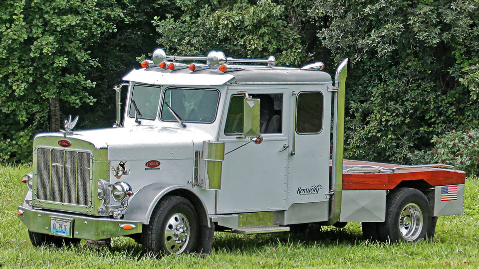

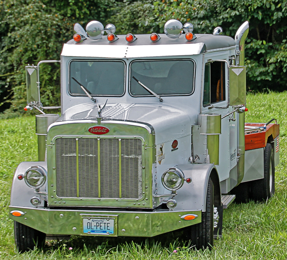

I knew the builder/owner of this truck personally and have seen it up close and personal on a number of occasions.
He told me just what model of Peterbilt extended day cab that he used for this conversion; but, that knowledge has escaped me.
I thought surely he must have added the extended length; but, to the best of my rememberance, he claimed it was a factory-original creation.
If he did add the extended area, he done a darn good job; as, inside and out, it looks factory-original.
The frame and running gear is 1989 D-350 Dodge/Cummins.
Can anyone pinpoint the year and model of the cab ?

I did find shallow mention of an extended day-cab 359X; very limited production and not a single picture.
However, the hood/breather area doesn't look like any 359 I ever saw = no scallop to clear the air tube.

We built a lot of the dies for the Peterbuilts during 1985 to 1991. Those fenders, cab corners and sleeper. Built the sunvisor tooling also. Top of radiator cover also. Built a front bumper die, but not that one in pics. Late 80's I would guess. Tracy

I've done bodywork on Pete's a long time and I've never worked on a cab like that. It is definitely pre 359 in my opinion. Looking at the windshields and door handles makes it look really old to me.

Having worked Petes since 1976, can say that is a conglomerate of several pieces of several different Model year Pete Conventionals as well hand built Extended cab and hoods.  Only the Cab Firewall and doors are actually all Pete.  Even the Grill is a custom reman.  Had considered that for the KW before got hard into the rebuild.
This most likely started out as a mid 60s 281 Single Axle Day cab.

This is my Dad's truck. The Cab is a 1951. It came off of a dump truck, if my memory serves me right. He stretched the Dodge frame 17 inches. The only thing that was cut on the cab was the grill.
