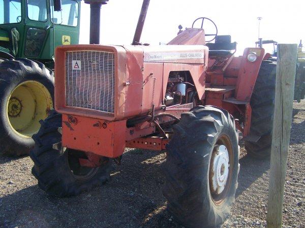

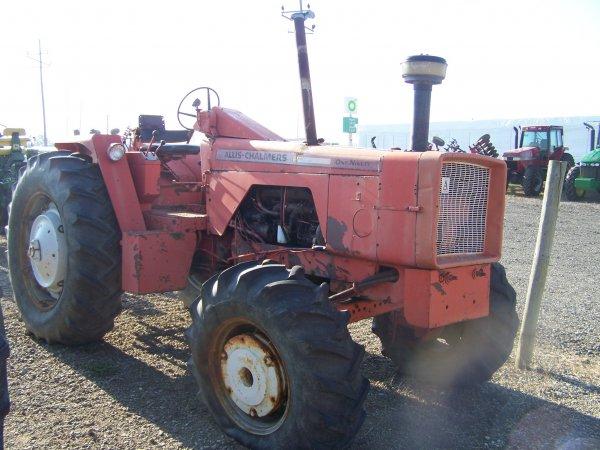

A hydraulic driven front end would probably be the easiest to do. Levy or a mud hog combine system could probably be done easily if you had a good way to power the hydraulics. Here is a 190 with a levy on it.

Those Levy set ups are pretty cool and seen on several Olivers in my area, BUT i think its alot easier to mate one up to an oliver than any other brand.  I always thought the missing 4WD D-21 looked like it had a Levy unit on the front of it

There is a D21 FWA in Gilbert Vust's museum in Portage la Prairie.  It is an aftermarket unit, possibly the one you are thinking of.
