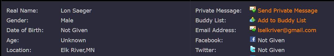

THere are several on this site who could sell you a GOOD crank... LON(MN) is one that should have several cranks.....e-mail below --- or send a PM.

That would be LON(MN) who got in touch with out about SEVERAL cranks he has in stock... I just passed along the info..
