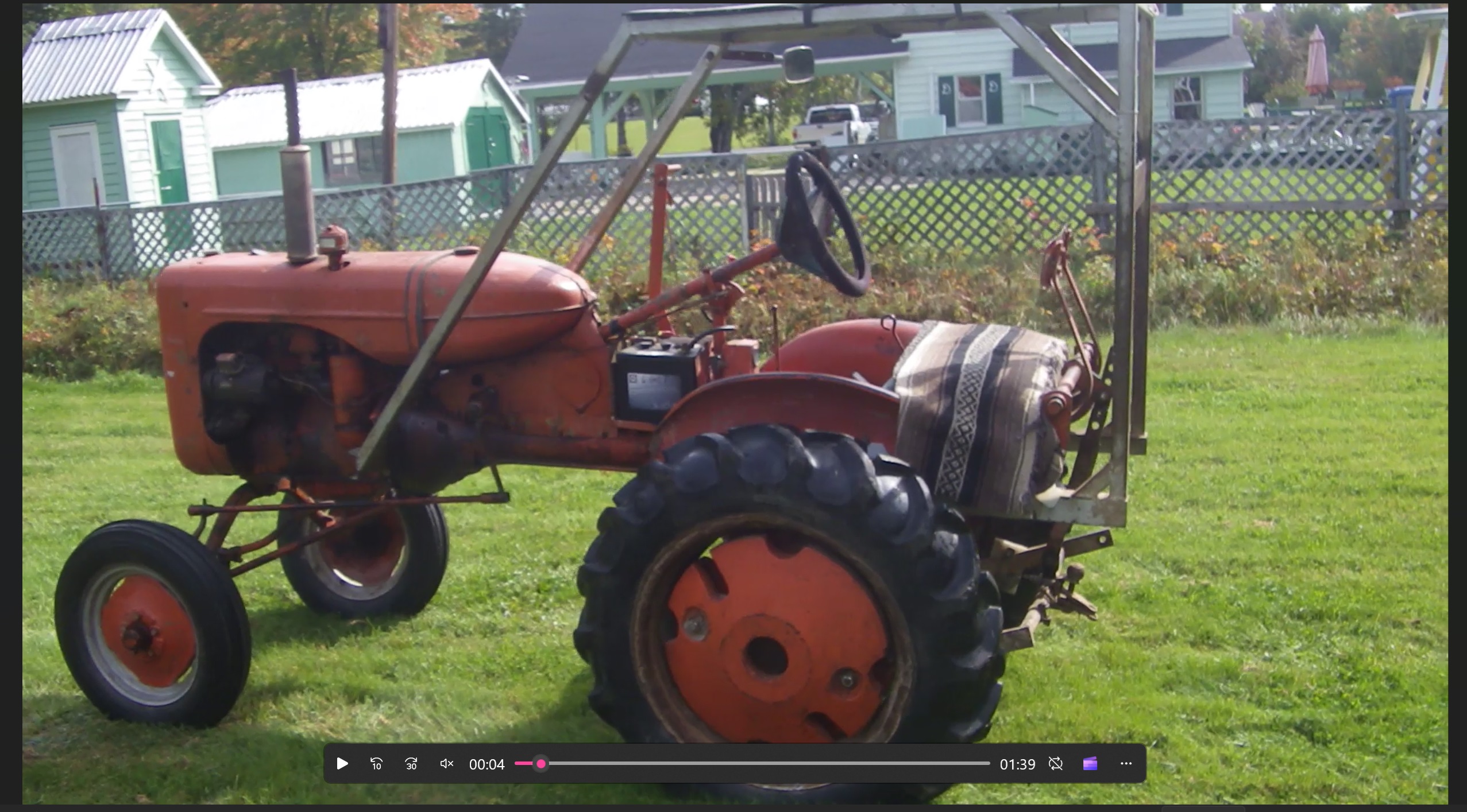

Hello all - First time posting (new account also) - have followed a lot of great discussion/advice/troubleshooting here over the last few years. Thank You
I inherited a 1948 B Allis Chalmers (6V, magneto, father in law had it -ve ground - I know they are +ve ground, have not switched it yet) - tractor usually started well with a quick choke, would hear it pop, shut choke off and it would fire up. It would have issues restating though if I ran it a while, shut it down.  Would need to wait 15-30 minutes, re-choke it and it would fire, shut off choke and it would start.  Tractor is on a woodlot in Canada and stays out of the weather when not in use.
In September it was running as described above then I shut it down but have not been able to get it started again.  Tried the above and no luck.  I was able to get it back in the shed (towing, winching) and have pulled the carb and sediment bowl, cleaned them thoroughly (carb kit),  new plugs with spark.  I have not opened the magneto yet.  I have a video so you can hear it but i don't think I can attach it here? I attached a picture for reference but you all have seen a thousand of these...  It sounds like it should fire up, just something has changed.  When choke is off it does not sound like it will start.  I tried some quick start ether spray as well and it chugs (sounds like it will start) but does not start.  Have not tried a bump start yet - not sure if that would do it.
Any help appreciated - I'm guessing it flooding but I can't seem to find a combo that it will start. I'm also wondering if it could be a grounding/short issue? I opened the ignition box to examine it and did not see anything. I did update the wire connector to the magneto (shut off) also as the wires were fraying.  This is a hobby tractor so I take all of this as part of the education, which I am enjoying.

well, if you got spark, that leads to believe it is fuel related... Since it does fire on ether ( but does not run) , that also leads one to believe it is fuel related...  Could be one jet is plugged so it does not suck up gas and hard starting..  Heavy chocking is another sign that the carburetor has a plugge jet.
I know you have cleaned it, but it may need the jets removed, cleaned, blow out with air, rod thru the holes with a torch tip cleaner.. etc...  Everything you said lead to believe it still has a carburetor problem.

If it were mine, first thing I would do is make sure that the "fresh" gas in the Fuel Tank is getting all the way through the elbow at the Carb.
Different spots along the way that gas could be blocked.
Next after that check would be the Air Flow through the Breather.

I agree it sounds like fuel - am wondering about the float and needle value also
I have drained the fuel a few times (when taking off sediment bowl) and am using fresh fuel (purchased this summer, stored in a cool shed)
I will take the carb off again - I did take the jets out, cleaned but will try that again
Ill check air flow through the breather as well - good suggestion
Tractor is at the woodlot so I will be up again on the weekend, get carb, clean during the week and return following weekend to reinstall.  Once the heavy snow hits I can't drive down the hill - need to snowshoe in then (am in Eastern Canada)

Disconnect your Mag kill switch and see if it starts. Could be the switch itself going to ground on occasions. If you disconnect the switch and it fires right up, there's your culprit. Happens quite often. Check fuel flow from the tank to the Carburetor. Disconnect the line at the Carb, open the petcock on the sediment bulb and catch the fuel in a clean jar or container. Let it flow for a few minutes and see if it slows down or stops, and then all of a sudden it starts again. If so, it's a fuel delivery problem and not neccessarily the Carburetor itself.
As for the Mag, when was the last time it was tuned up? The points may be getting oxidation on them due to a failing gasket or just age. Condenser will play havoc like that as well. If the Mag has the old style tar taped Coil in it, it could be leaking and grounding out on the inside of the Mag housing. Replace the old tar taped Coil with the newer Epoxy Coil whether the Coil is bad or not. Those old tar taped Coils were the pits!

I did try disconnecting the mag kill switch - was thinking it might be that as well but it did not fix the issue.  Have checked fuel flow at sediment bowl, end of copper tube to carb and bottom of carb - fuel flows well all points there
Mag has not been tuned in a while - I am holding off on that for now as its new territory for me and tractor is in a small shed, 20 miles from my house. I was hoping to do a number of jobs like that (mag, starter, generator, wiring...) in my garage at home but I need the tractor running first. (steep hill to the cabin/woodlot, low trailer, need to drive tractor to access point)
