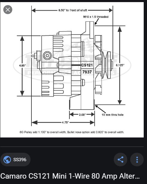

what one is physically smaller delco cs121 or the denso

no one wire stuff ever gets installed here.     looks like the denso is alittle smaller  , thanks for the info guys
