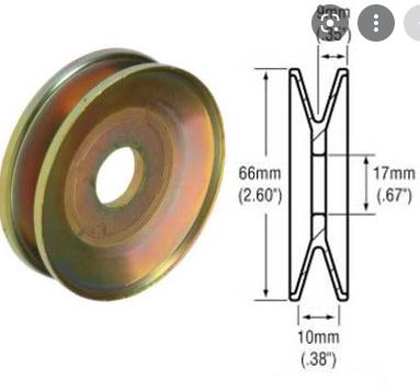

Post Options Post Options   Thanks (0) Thanks(0)   Quote John426 Quote  Post ReplyReply Direct Link To This Post Posted: 29 Aug 2021 at 5:04am
Hi
Is it this pulley size diameter of 2.60" O.D, that you have  on your alternator Delco 10SI?
Or on the other alternator?

Post Options Post Options   Thanks (0) Thanks(0)   Quote Steve in NJ Quote  Post ReplyReply Direct Link To This Post Posted: 31 Aug 2021 at 7:17am
If you wire your Tractor as a three wire system, after 400-450 rpm, the unit will start charging. No need to rev the snot out of the engine to get it to charge. Pulley diameter doesn't matter with a three wire system. The pulley pic you posted looks like a 3/8" belt. You need a 5/8" belt to match the other pulleys on the engine. Most 1 wire Alternators can be changed over to a 3 wire system with the VR's that are in them.  HTH
