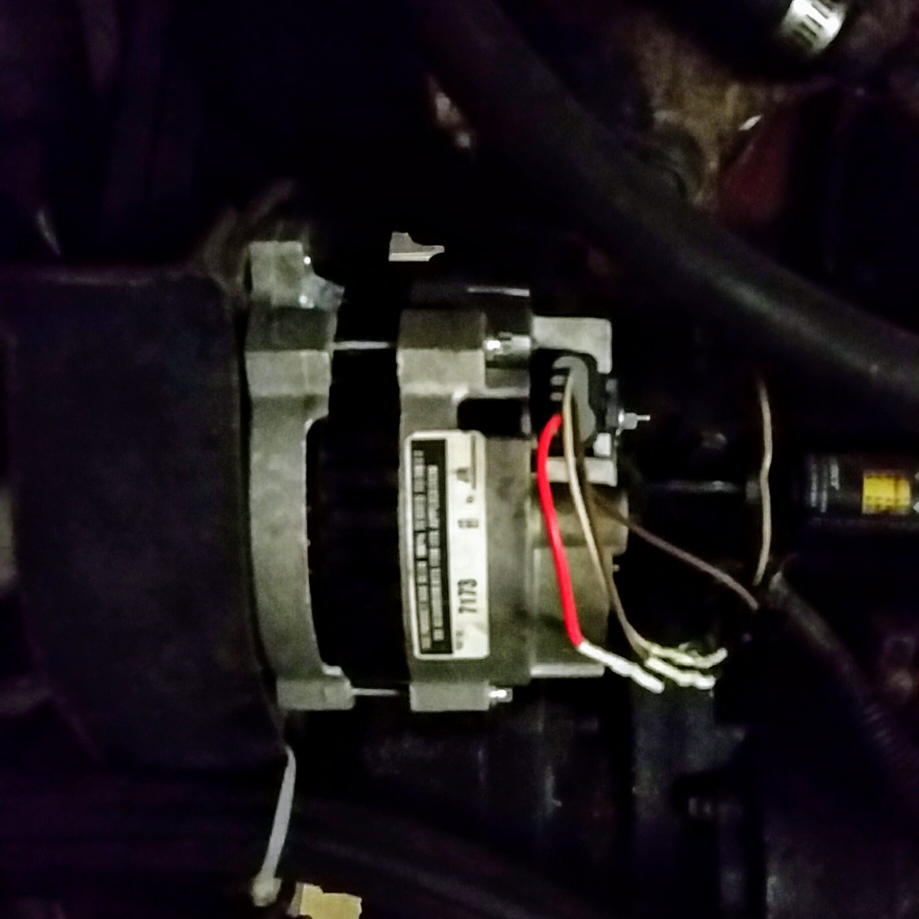

Gonna switch the d14 over to an alternator since the genny had crapped out.  a friend had 2 alternators in his garage that needed rebuilt one off a 1979 firebird and another from a 69 buick gsx.  I only needed them to figure out the brackets so no big deal they needed rebuilt.  firebird alt. was to big, the gsx was perfect! spent the rest of the day fiddling with the brackets to get every thing lined up. the next morning decided to price a alt. online. to my surprise it was only 50 bucks, good, checked the specs. it has an external voltage regulator!!!!! all that work for nothing!!!  luckily between me and the fella at the parts store we found a alt from a 1985 celebrity 4cylinder was the same size as the one from the gsx.
moral of the story, check to make sure it's the part you want before spending all day making brackets!!!!

You didn't waste your time if you used a "DN" series Alternator for mock up. Its basically the same configuration as its "SI" cousin even it it was clocked a little differently. The cases and the mounting is basically the same. The wiring of coarse is different being a external VR is used with a "DN" series vs the internal regulated "SI" cousin.

when I pulled the dash foreward to get at the ignition and alt meter wiring I pulled all the conections out for the ignition...ad to figure all them out, before running any wires for the alt.  I also had to disconnect the power booster and oil pressure lines, just an fyi, if you start the tractor with those lines unhooked it will shoot oil 12 ft....want to guess how I know that?LOL

I just put a CS130 on my 7000 after my 10si got a little flaky on me last year. Everything mounted right up, only thing is the tach feed reads about 10-15% lower for some reason? But it's nice not having the alternator light coming on faintly with the stadium lights and a/c going!

pulley was a different size, I took the pulley off the generator and put it on the alternator

I used the pulley from the 10si and the same belts. It aligned right up using the mounts for the 10si. I'm not sure what could be different?

When you say "tach feed measures", what do you mean? Are you driving the tach off the P terminal of the alternator? The voltage shouldn't matter much here. The tach should be reading the frequency. The frequency would be the same no matter which alternator, providing the same sized pulley was used.

There is nothing inherent in the construction of an alternator that guarantees the same frequency for a specific shaft speed. The frequency is set by the number of poles on the rotor and the shaft speed.

I imagine the cs130 has a different frequency than the 10si. I would still recommend it for the low rpm amps. I'll have to keep you updated on reliability. This is the first season.

10% error seems odd, though. If it had 8 poles instead of 10 it wouldn't be a 10% difference.  Same goes for if it had 10 instead of 12 or 12 instead of 14.

It's probably closer to 15%. WOT high idle reads about 2200-2300 instead of a little over 2500 rpms.

I'm not familiar with the tach. Many tachometers have DIP switches that allow you to change the ratios. If your tach has a case that can be opened, you might want to take a peek inside.
Edit: 12 and 14 pole alternators are the most common. If you replaced a 14 pole with a 12 pole alternator your error would be almost 15 percent. You need to dig deep into alternator specs to determine the number of poles a particular alternator has.

Thanks for the help! I'll look into it! I wonder if the niehoff alternators used a smaller pulley that would correct the reading?

yes, if the pulley was 15% smaller, you would get 15% more pulses out of the alternator  for the same MOTOR revolution.

If you have a 2 inch pulley on the alternator now, switching to a 1.75 inch pulley should just about bring it to where you want it.
