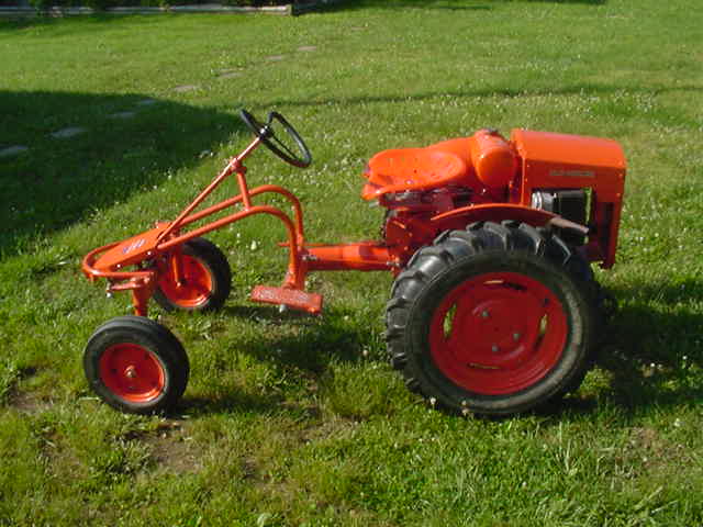

Kevin, There is a picture of that half scale G.

That's a nice lloking half scale!!
