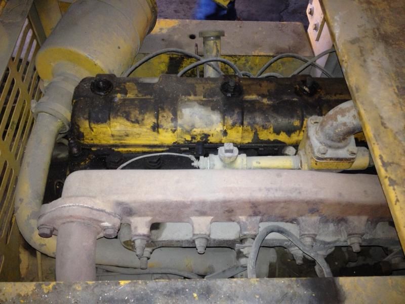

Here are a few pictures of the machine.

Its an allis/buda engine is some type b230 maybe? 10w30 is fine for motor oil. Aw32 or 46 for hyd. Call a komatsu dealer for a service manual or look online.
