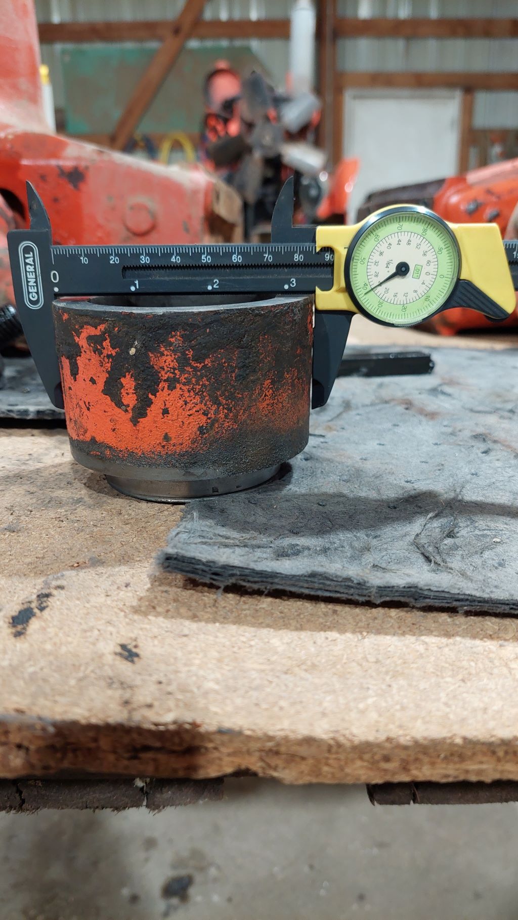

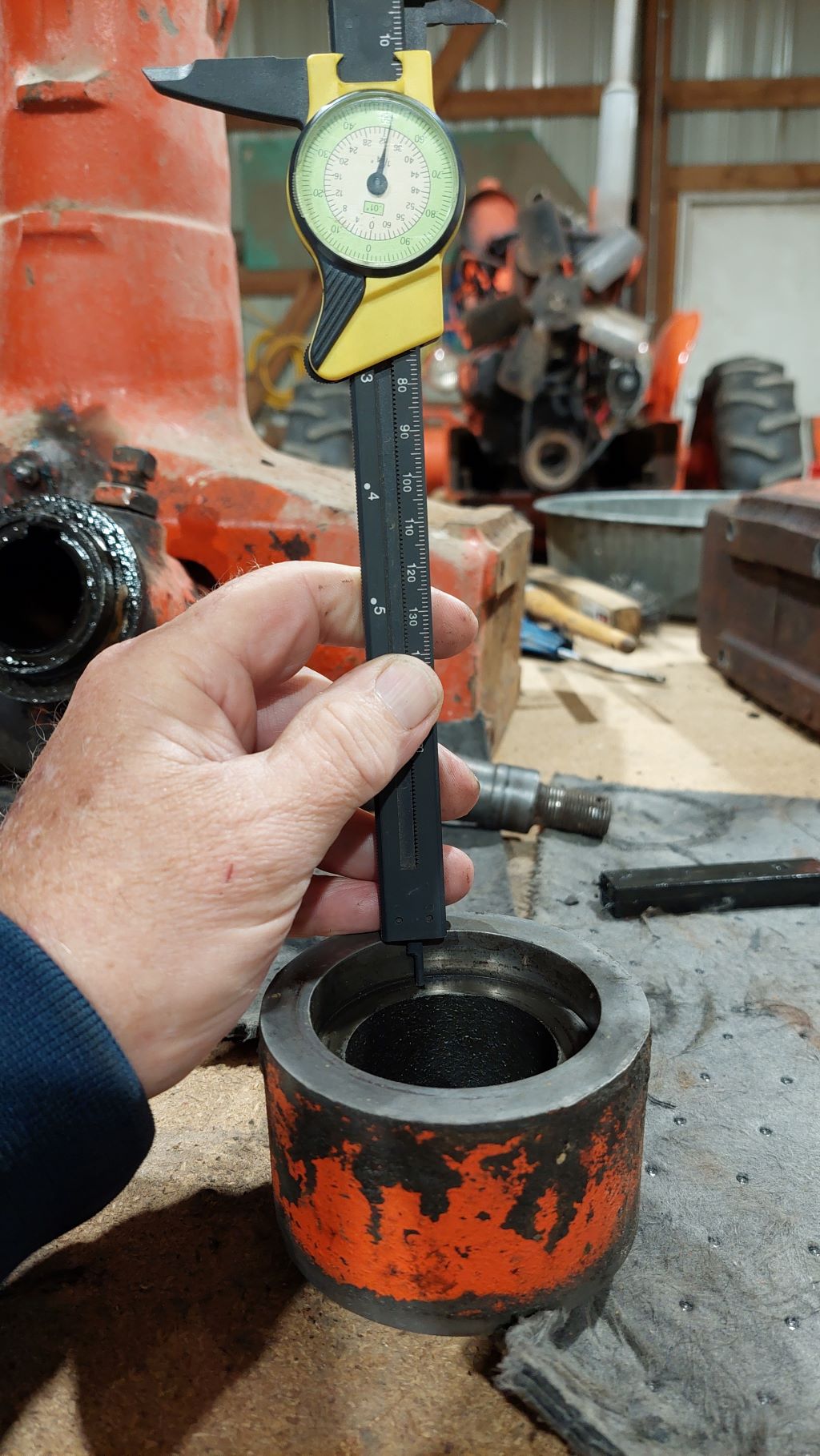

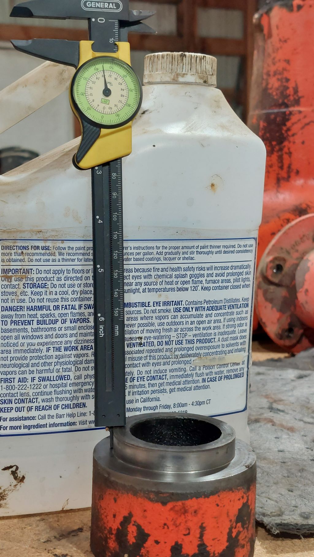

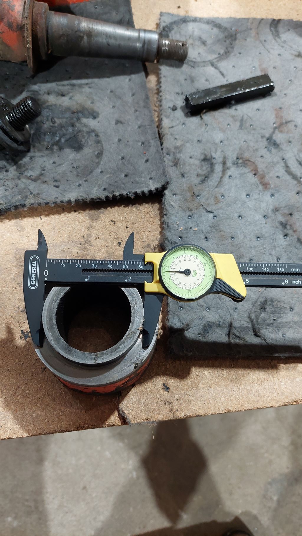

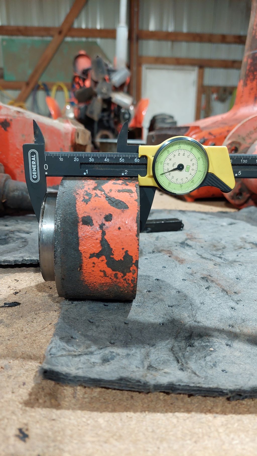

Any chance you could take some measurements of the spacer?
Height, diameters of inside, outside and step of the ledge.
I am assuming other side is flat.
I might want to make one for my picker.

Post Options Post Options   Thanks (0) Thanks(0)   Quote jmrehn Quote  Post ReplyReply Direct Link To This Post Posted: 03 Jun 2025 at 5:19pm
53WD

Post Options Post Options   Thanks (0) Thanks(0)   Quote kevin LA-CA Quote  Post ReplyReply Direct Link To This Post Posted: 03 Jun 2025 at 9:13pm
Jim
Super! Thanks for the great photo documentation.
I think I can turn one up.   Then extend the spindle for my picker.
