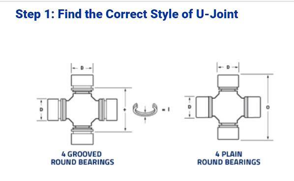

picture is not going to help... u-joints are specked by the bearing cap OD and the WIDTH from one edge of the cap to the other.... ... Probalby 20 different sizes or more... get those numbers and you can cross reference.

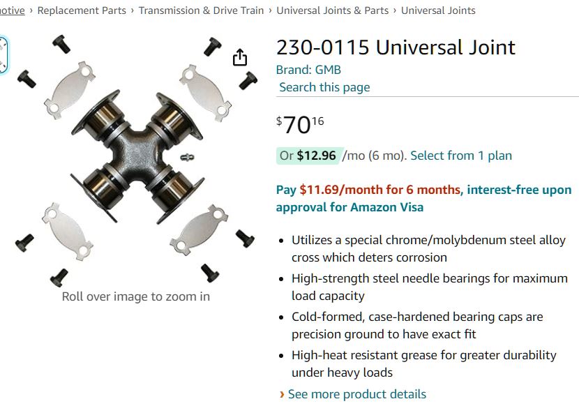

Post Options Post Options   Thanks (0) Thanks(0)   Quote CAL(KS) Quote  Post ReplyReply Direct Link To This Post Posted: 08 May 2024 at 6:06pm
Ok that is the second style TL-12. Mine is first style. Front and rear universal joint I have is 230-0115. May not be the same for you

Post Options Post Options   Thanks (0) Thanks(0)   Quote steve(ill) Quote  Post ReplyReply Direct Link To This Post Posted: 08 May 2024 at 6:24pm
this is CALS u-joint... early model

Post Options Post Options   Thanks (0) Thanks(0)   Quote AC 89 Quote  Post ReplyReply Direct Link To This Post Posted: 08 May 2024 at 6:28pm
Mine looks just like that with the caps that bolt over the yoke. I haven't gotten the machine yet that's why I asked if anyone would know what u-joint it would need. I'm getting it this weekend.

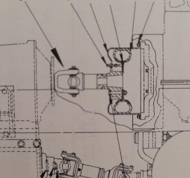

Post Options Post Options   Thanks (0) Thanks(0)   Quote nowaktj Quote  Post ReplyReply Direct Link To This Post Posted: 27 Jun 2024 at 4:21am
Hi guys-I have a "newer" TL12 with the D17 engine.
The driveshaft between the engine and transmission has been completely cobbled (even the tire has been removed).
What I want to know is whether this driveshaft has a slip joint in it or is it a solid connection?
I have included an image from a TL12 with a 6 cylinder engine showing a solid connection.  My parts book does not show what this looks like with the 4 cylinder engine.
Thanks in advance.
Edited by nowaktj - 27 Jun 2024 at 4:22am

Points: 90719
Post Options Post Options   Thanks (0) Thanks(0)   Quote steve(ill) Quote  Post ReplyReply Direct Link To This Post Posted: 30 Jun 2024 at 1:15pm
almost EVERY drive shaft has to have a slip joint to make up for minor difference in component installation, or movement of the trans / axle / engine.. Would be hard to build ANYTHING with a solid length shaft unless everything was perfect dimension.

Post Options Post Options   Thanks (0) Thanks(0)   Quote nowaktj Quote  Post ReplyReply Direct Link To This Post Posted: 30 Jun 2024 at 1:21pm
The t l's have a rubber tire in a drum Adjacent to the engine's flywheel. My question is Whether they have a slip joint when it has the four cylinder engine. 6 cylinder do not.

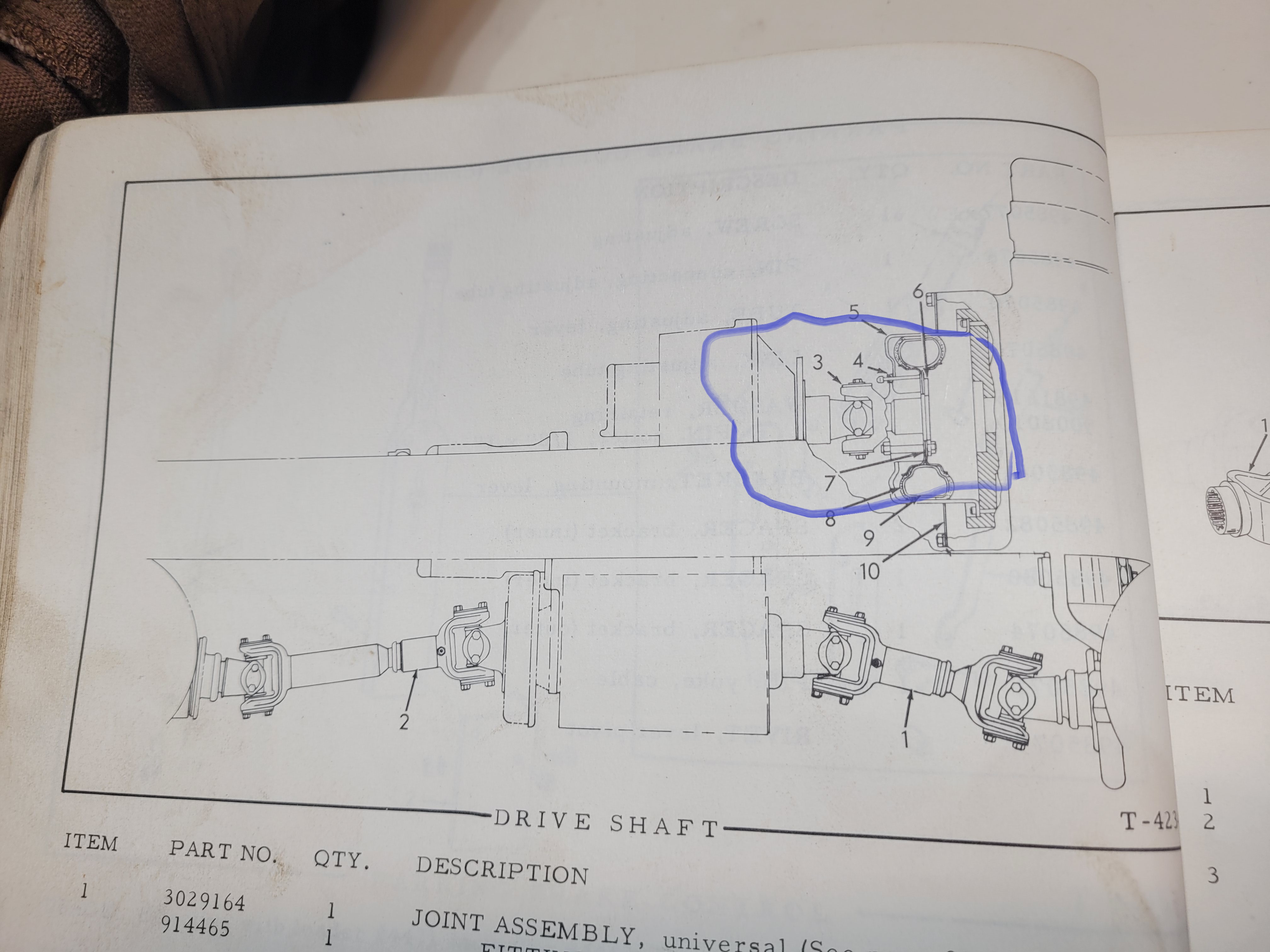

Post Options Post Options   Thanks (0) Thanks(0)   Quote nowaktj Quote  Post ReplyReply Direct Link To This Post Posted: 30 Jul 2024 at 10:21am
Found a manual at the Orange Spectacular and it shows a tube of a driveshaft taking up the extra distance when the 4 cyl D17 engine is installed.
Edited by nowaktj - 30 Jul 2024 at 10:32am
