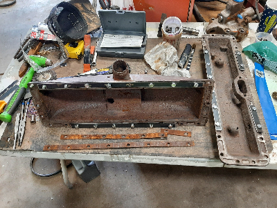

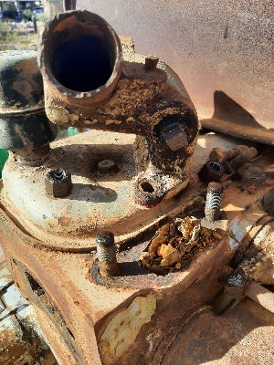

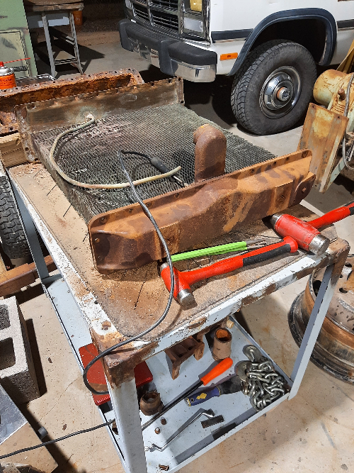

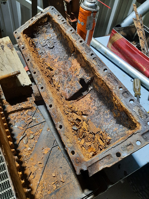

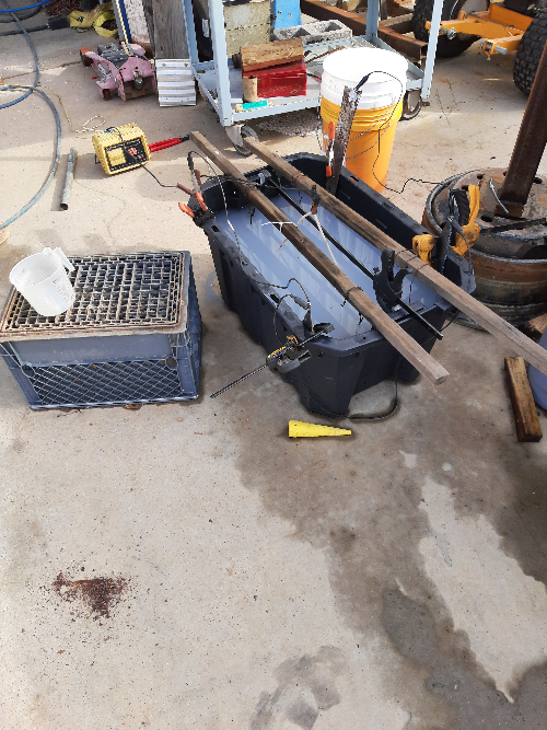

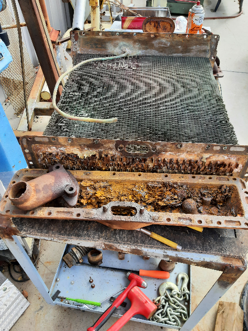

Currently rebuilding a 1937 wm crawler radiator and using electrolysis to remove rust from the supports, tanks, ect.

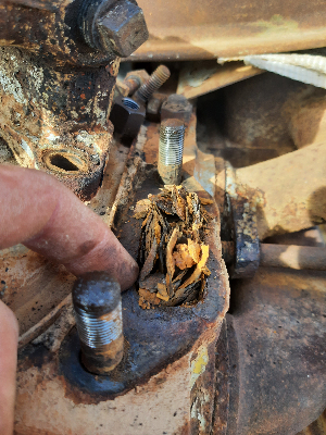

To start the tanks bolts were so rusted a decent amount broke. The water outlets bolts snapped off and was seized with rust, took hours of fighting to get it off. After that the bolts came out easy with some heat and kroil.
Also thinking about rebuilding the water pump but the flat head screws are frozen in place. This is making me hope i can get away with leaving it as is. Even using a impact driver only loosen 1 of the 4 screws and bent the bit/ screw heads.
I figure if people are interested ill post more about this and more pics as i go along.

Great work you are doing. Hopefully the core is not to far gone. But they used better stuff back in the day.
Anything to soften the rust in the tubes would be a big help. I have done a number of Cat radiators of that design. Some I literally pounded brass weldall welding rods down the tube. Then with first rod still in tube push a 2nd and 3rd rod thru. Then finish a strip of aluminum material.
I have had better results removing broken bolts in the cast iron tanks by welding a nut on the broken piece. Some I have welded 6 or 8 times but so very easy to do compared to drilling.  And I have never screwed up the threads. As the weld doesn't stick to the cast so even broke a 1/4 inch down start welding. Get it flush, clean weld add a flat washer, weld and clean again, then weld nut on. Let it sit until you can hold you hand on it, longer is better. Then use impact at a low setting to rattle and vibrate. Something with the arc focuses the heat in the broken piece, I believe increasing the shrink and swell factor to loosen the rust.

Thanks for all the info and suggestions!

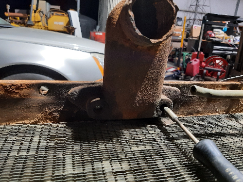

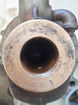

 I ended up using a random long skinny rod, kroil, av gas, and air. after i got most of the tubes cleared enough I roughed up the coating of the rod and put it in my drill, running it back in forth while adding kroil. Now they are all clean and clear and hoping theirs no leaks. Not gonna lie might end up using stop leak if it does, since repair would probably cause more damage.
As for the bolts the worst was the lower outlet. I babied them when attempting to remove them gently rocking back and forth. I fought with getting it removed for hours. I couldnt use much heat because the soldier ect. I tried using a soldiering iron and propane torch, heating it a few times. Also used a super thin hack saw to slice through the gaskets (which were like the hardest epoxy or something. All so i could get drift between it and the radiator and help loosen everything. Ended up losing the battle that night but the next day my stepdad took a endmill to it and between a little beating, prying and wiggling back in forth it came off. VICTORY!!

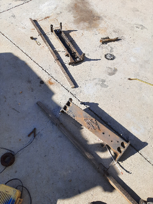

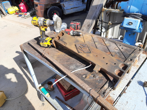

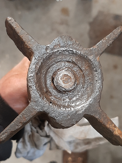

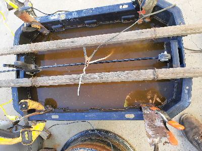

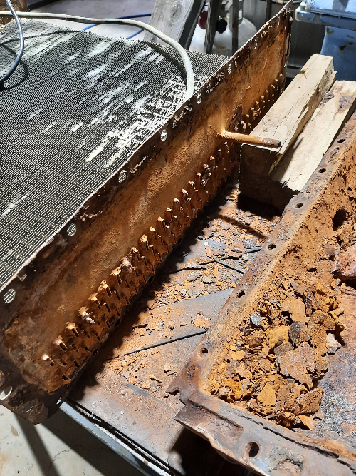

This is after a day of electrolysis and some wire brushing ect. Sorry i didn't take beforepics. After two days.The radiator core after cleaning all the cork and corrosion off. Theres more to come, been working on the water pump and the fan hub/belt tensioner also. Then gonna have to clean the block out. Hope everyones doing well having fun with their projects.
Edited by WM5377 - 08 Jan 2024 at 12:21pm

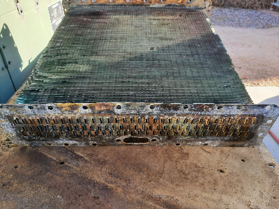

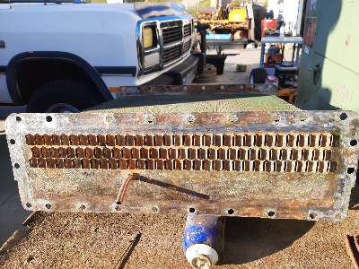

Just to be clear i didn't use electrolysis on the radiator core. Just good old wire brushing and elbow grease. also as mentioned above cleaned all the clogged and dirty tubes out.

On the Radiator Core, if there is considerable Corrosion on the Between Tubes Copper fins it will not adequately exchange heat.  That was a Issue on a few of my older machines over the years.  If they crumble when touched they will not accept heat from the tube.
Thanks for the advice I'll make sure to keep a eye on the temps. The fins seem ok, just green from the years. They are thin, but I think it will still work for what were using it for. (going to the yearly tractor show and maybe to pull something) It will probably get run a handful of times a year just to keep things moving ect.

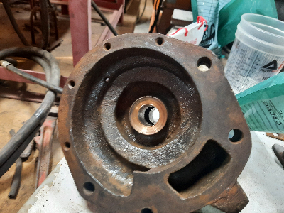

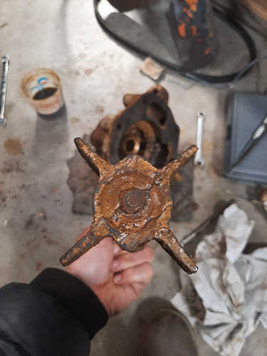

Sorry its been awhile my health hasn't been the best. Ive gotten a few things done.

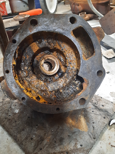

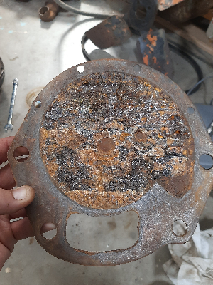

Got the water pump cleaned out and pulled the front bushing out. Found out the oil port hole was drilled in the wrong location. So I drilled it out in the right spot and dremeled a channel to the old hole so both side get lubed. I also chamfered both holes.

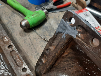

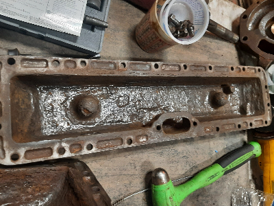

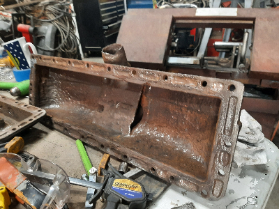

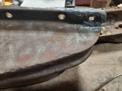

I made some new brackets. It was fun since the old ones were stretched and the bolts dont all line up on the same plane. Then i took a burr to the rust and clean as much as i could without messing with the sealling surface. Still to scared to remove that since it might take to much of the sealing surface away. I also used a large square of sand paper and a flat piece of particle board to get the sealing surface as flat and even as possible on the tanks. Its probably gonna take a decent bead of rtv to seal everything. Glad the systems not under pressure. Still debating if we should try to use rust converter and red kote or another sealer. Or if we should just do the rust converter or nothing and run it as is. With how bad the tanks are rotted its hard to put money into them vrs maybe trying to find different tanks.
I also jb welded a piece that had broken of the corner of the top tank. We were going to braze it but since its so old and rusty we didnt want to risk it. Also cast iron is supposedly one of the hardest things to weld/braze and we dont have any experience doing it. So steel jb weld it is.

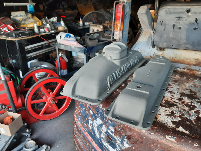

Sorry its been awhile. Recently used rustoleum rust reformer and self etch primer on the radiator tanks, and supports. Heres some pics, I thought I had taken pics of the rust reformer coat but guess it didnt save or im miss remembering.
I dont know why the first pic is super grainy sorry.
