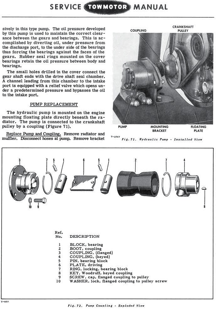

The diameter of the keyed portion (where the pulley mounts) is 1-1/4". I'm not picturing what yo are trying to do. I assume you are trying to drive the pump at the pulley end of the crankshaft.
Many pumps drive off an adapter bolted to the crankshaft pulley. There are already two tapped holes in the pulley. May need to machine the pulley face to true it up, but would it be possible bolt an adapter to the pulley? Need some flexibility in the drive line. Maybe a LoveJoy coupler. Anything other than a ridged coupling.
Be interested in what you end up with.

Here's a picture of pump installed on an N62 in a Towmotor forklift.
