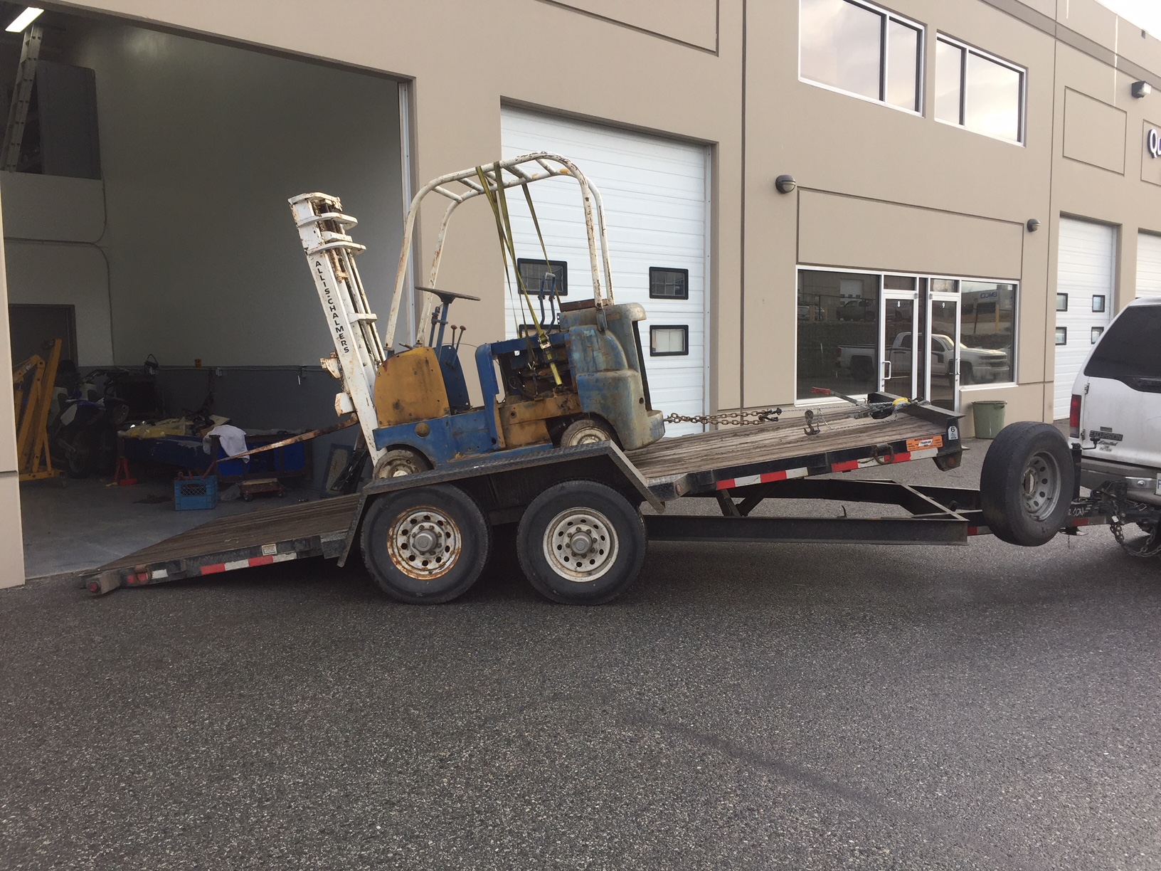

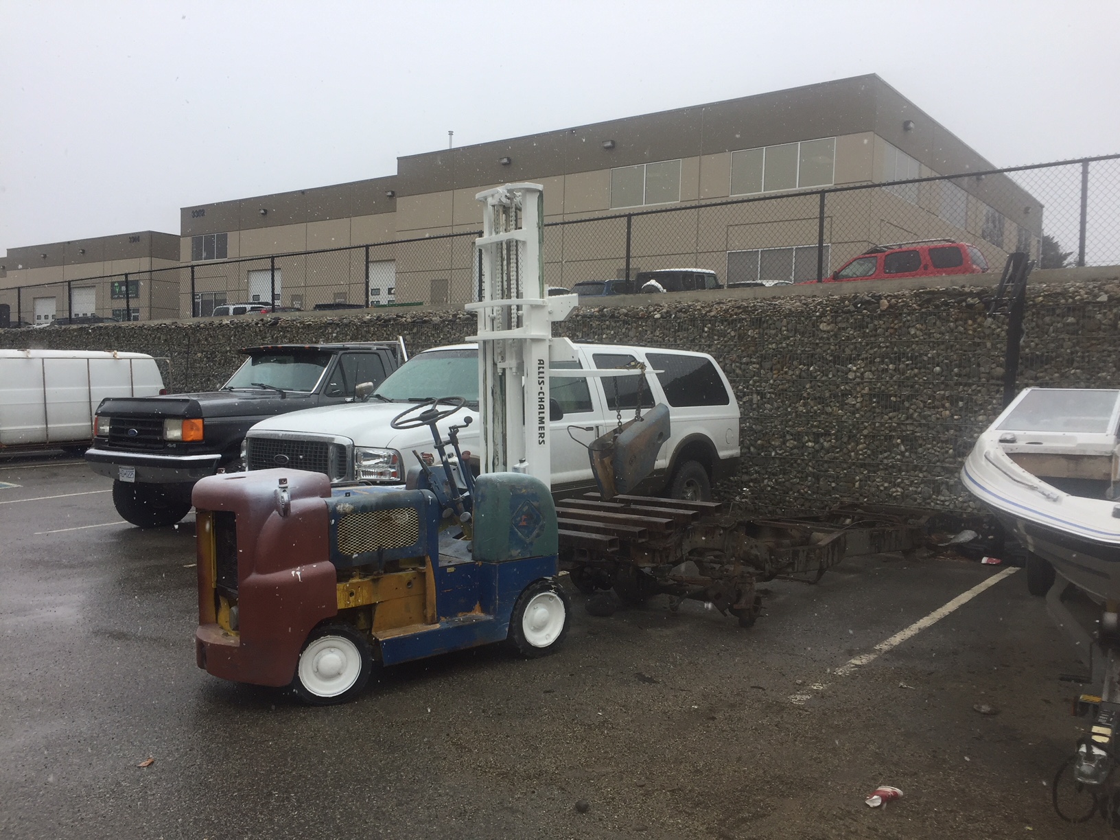

Hi guys and gals,

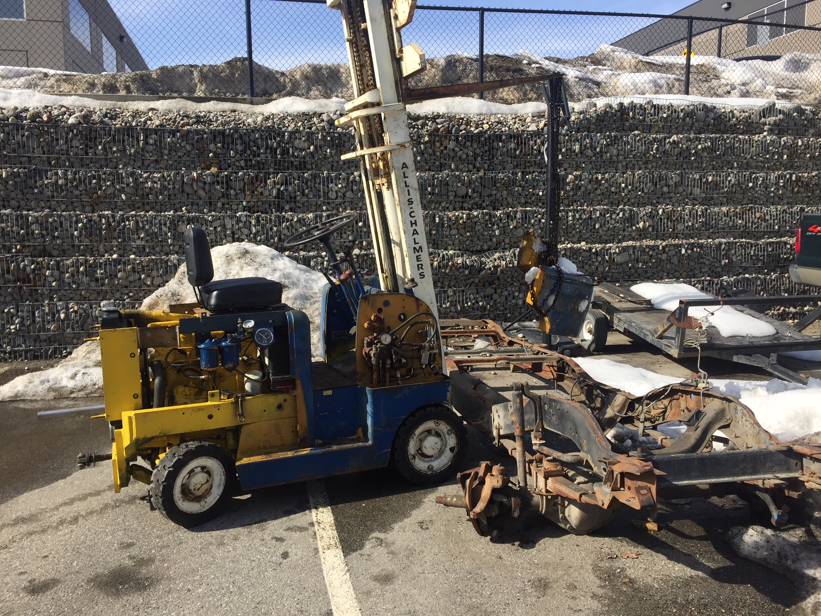

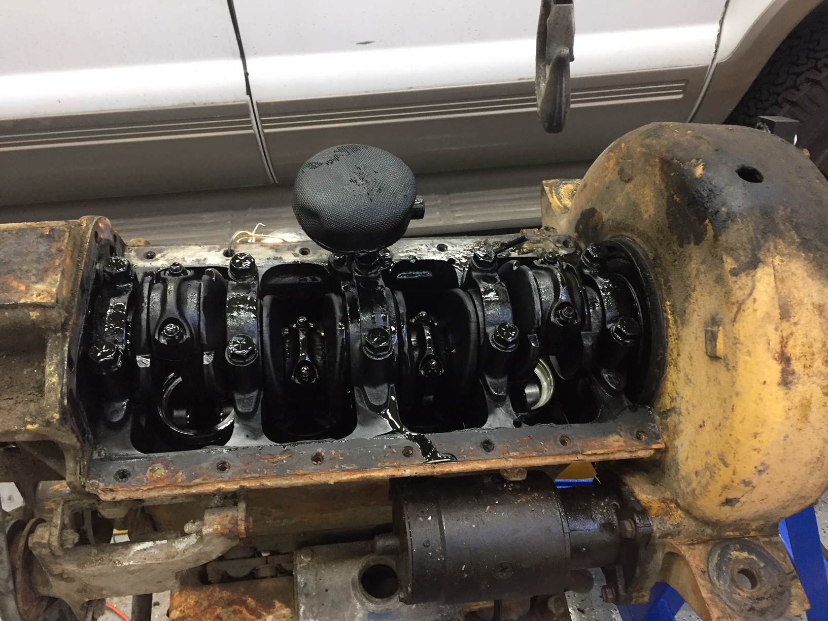

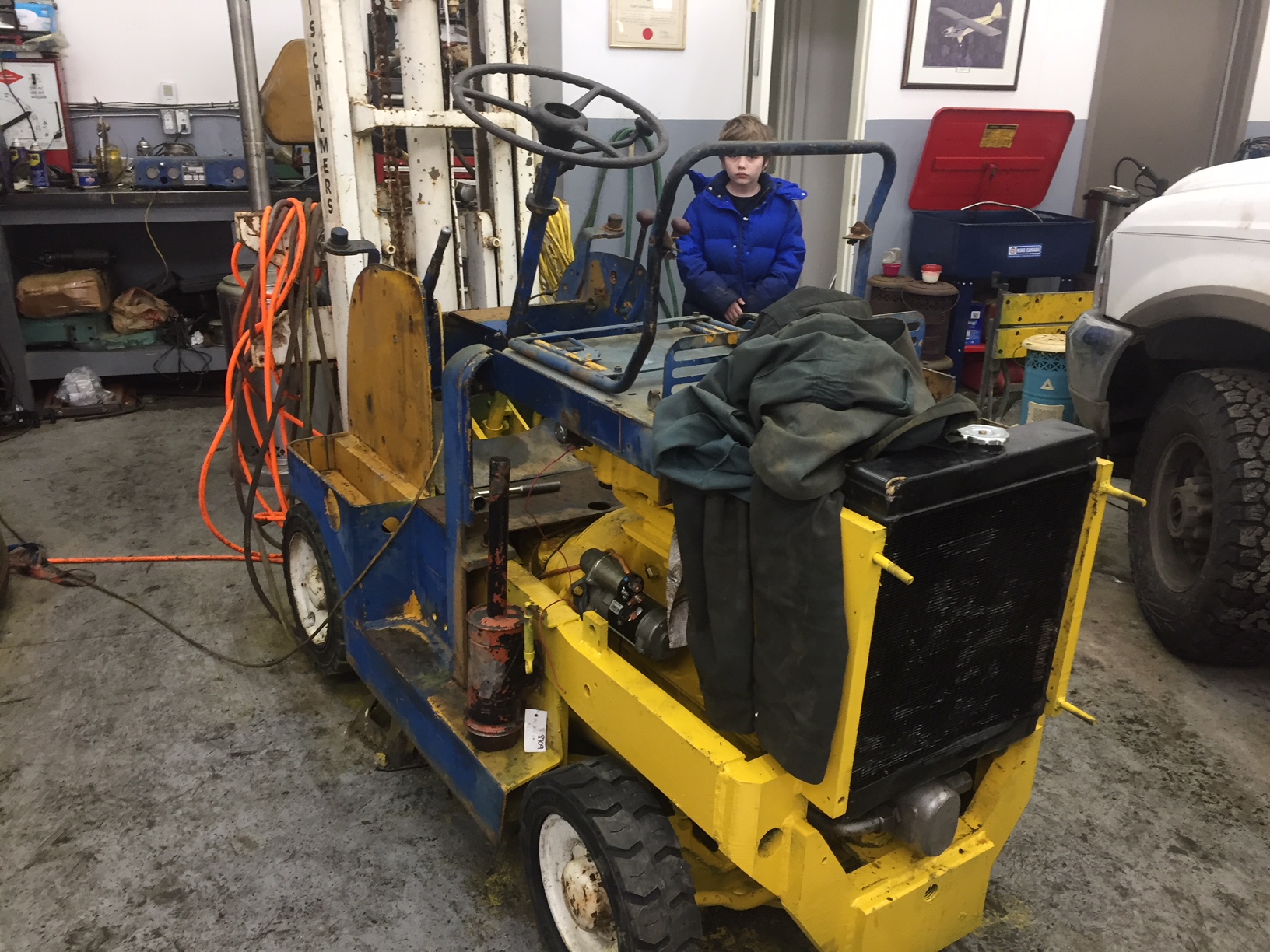

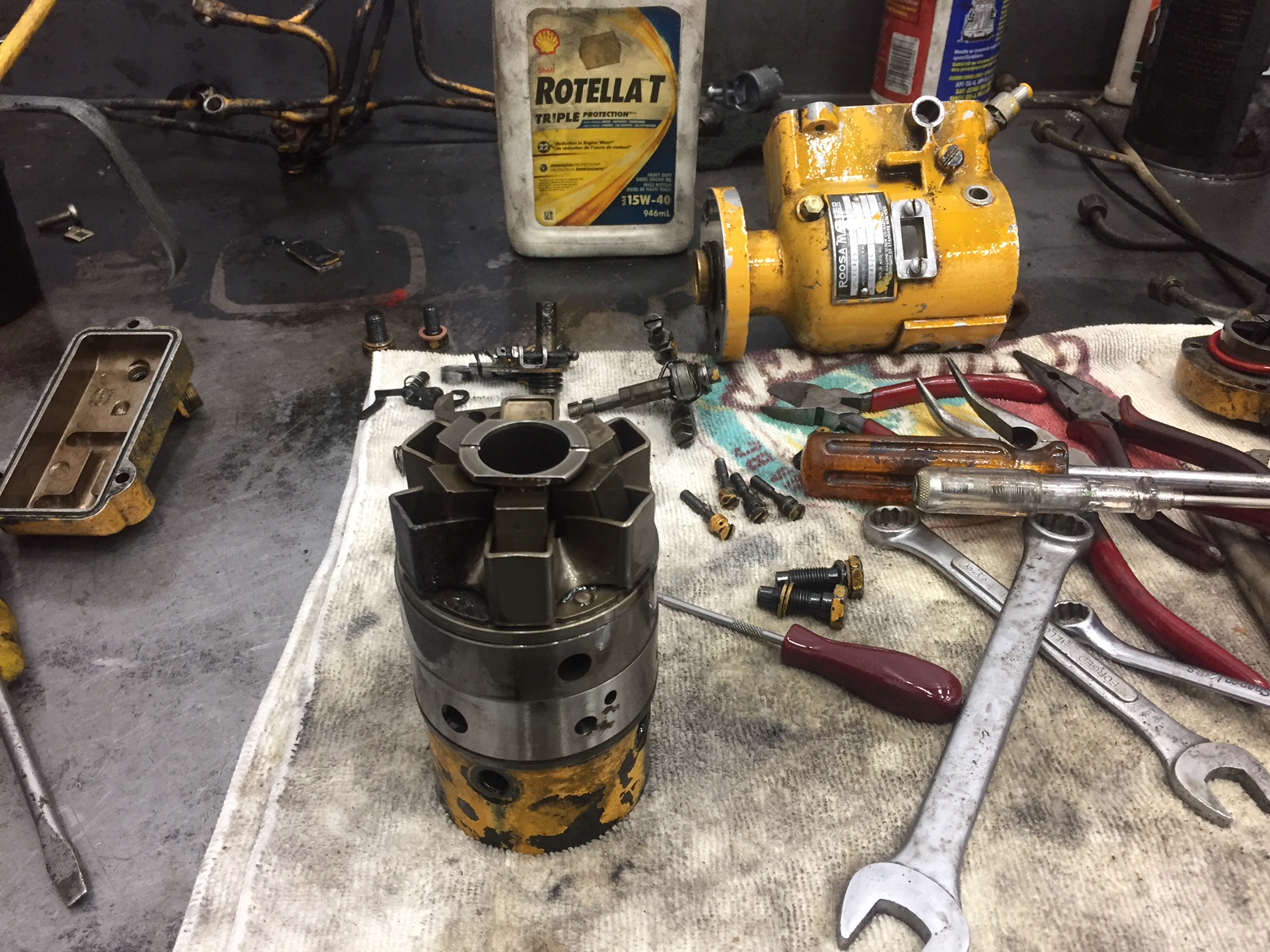

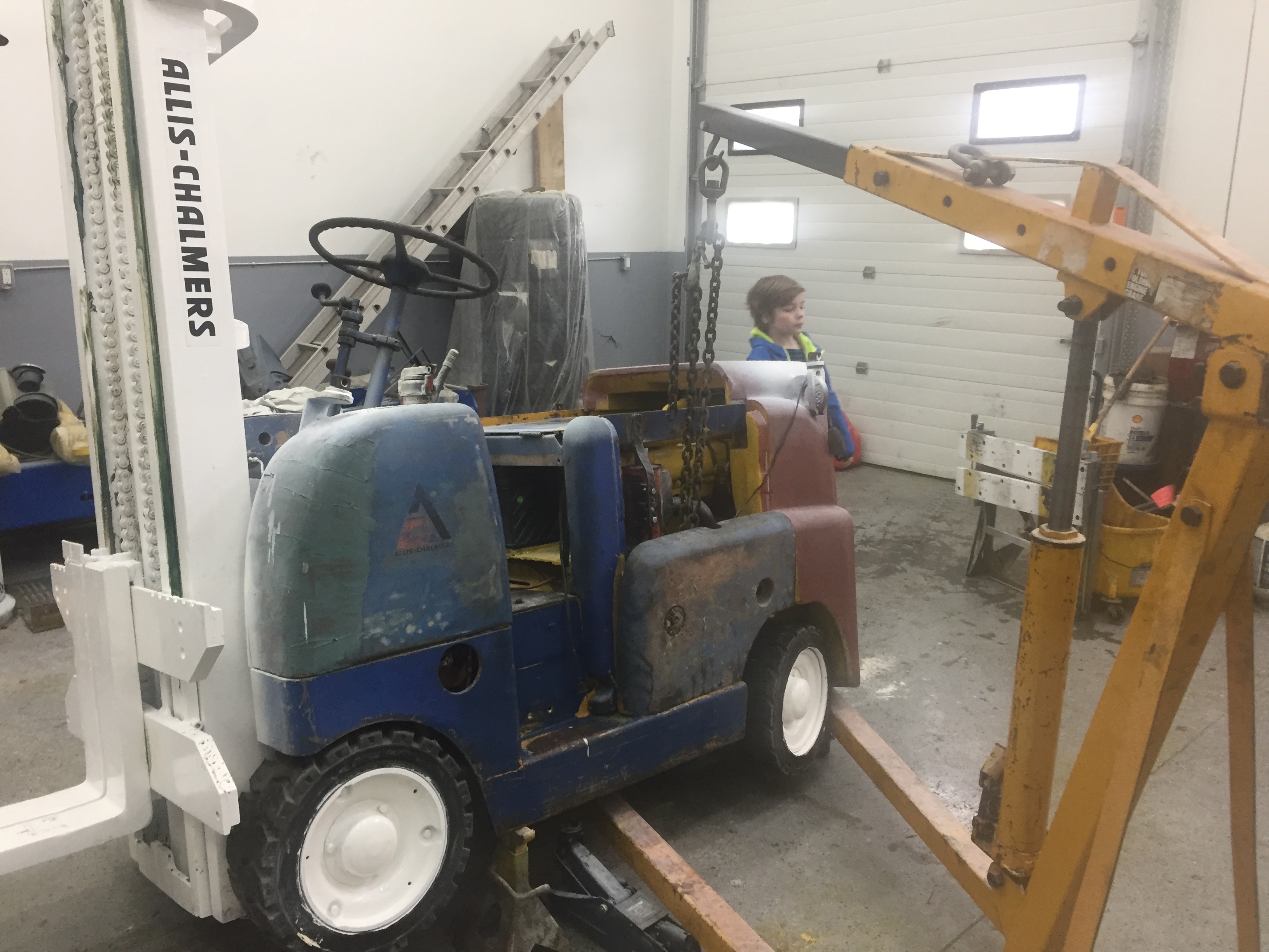

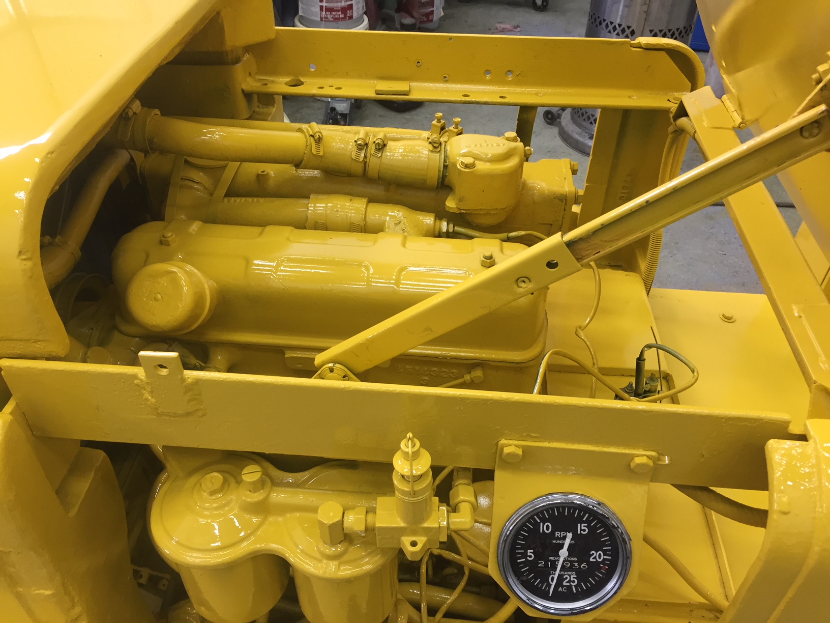

Thought I'd post an update to my 1965 Allis Chalmers FDX40-24 Lift truck with a Buda D175 diesel engine (called the Safety Diesel).  This was used around dangerous and hazardous materials, with no electrics and a watercooled exhaust and spark arrestor.  I bought this unit 3 months ago with the intentions of a quick repair and use it to put up a 2 post lift I bought.  After that I would work on it as time was available to slowly repair it.  Well as things turned out it's been 3 months into the repair and I can finally say it's only 2 weeks away from being finished.  I restored everything back to serviceable condition and am in the process of painting and finishing the unit.  I have to say I've never seen a piece of equipment  this abused before.  Everything was totally spent from the cracked engine block, water cooled exhaust manifold, seized fuel pump, broken steering box and damage from being left out in the field and dragged around the farm with a tractor.  From what I can figure, it was the steering box that finally brought Allis to a stop, unable to steer the unit, it was dragged out to the field to rest.  It wasn't until I saw it in the local Craigslist that it was dragged onto my trailer and put in my shop.  I was able to get both the service and operators manual for it so I could at least know how things were when it was in service.  Overall it runs pretty good all things considered and I will more than likely rebuild the engine in future, but for now it will be put back in service and repaired on a need be bases.  Here's some pictures and video's of Allis.:
Run up and test hydraulics

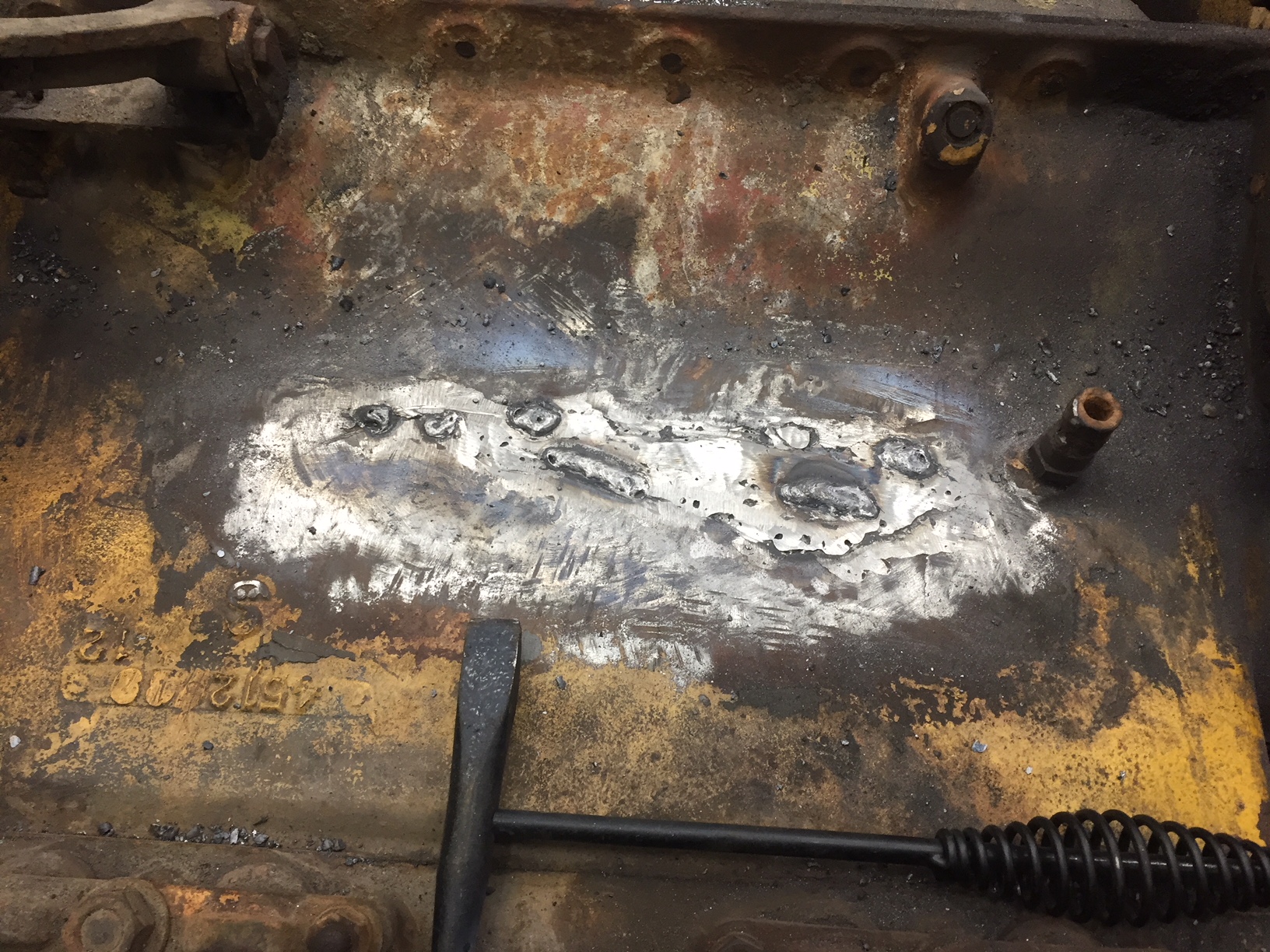

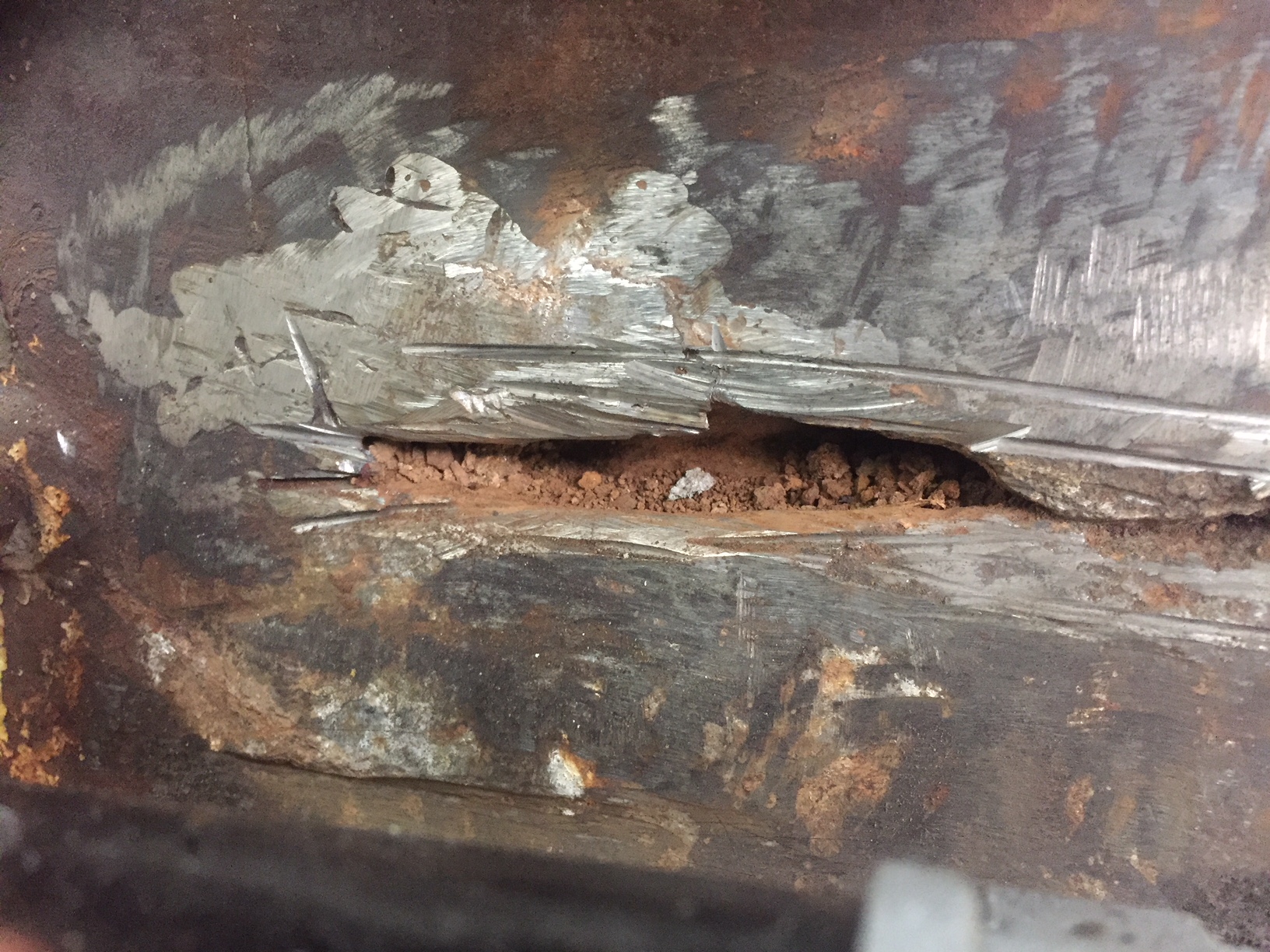

Done the fab work and prep for paint
Test2

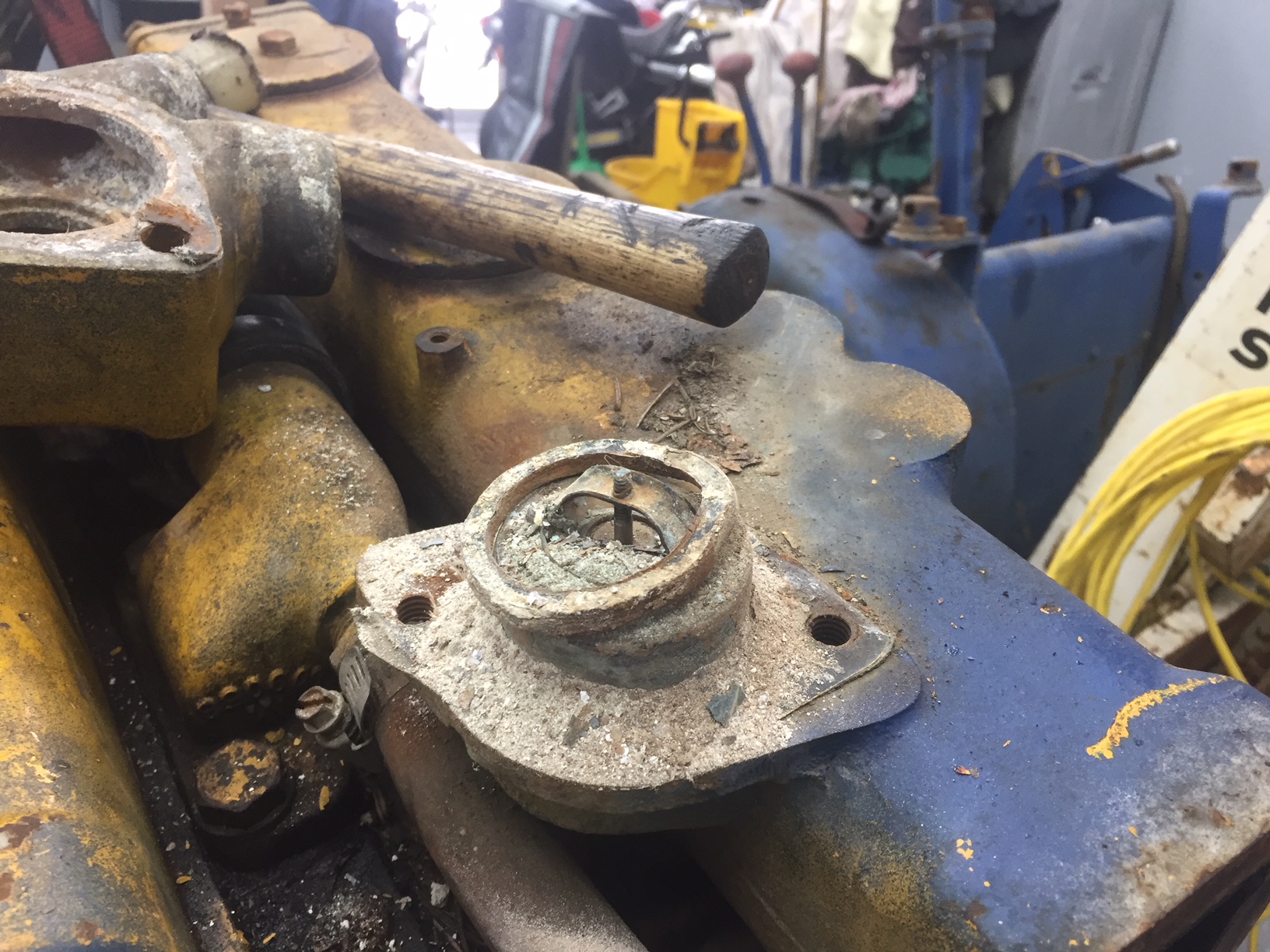

Thanks Jerbob, the most time spent was welding the block and manifold.  Second was the blocken steering box that was missing the bottom bearing race.  I ended up machining the upper and lower races to fit ball bearings as that's all I can find that would work.

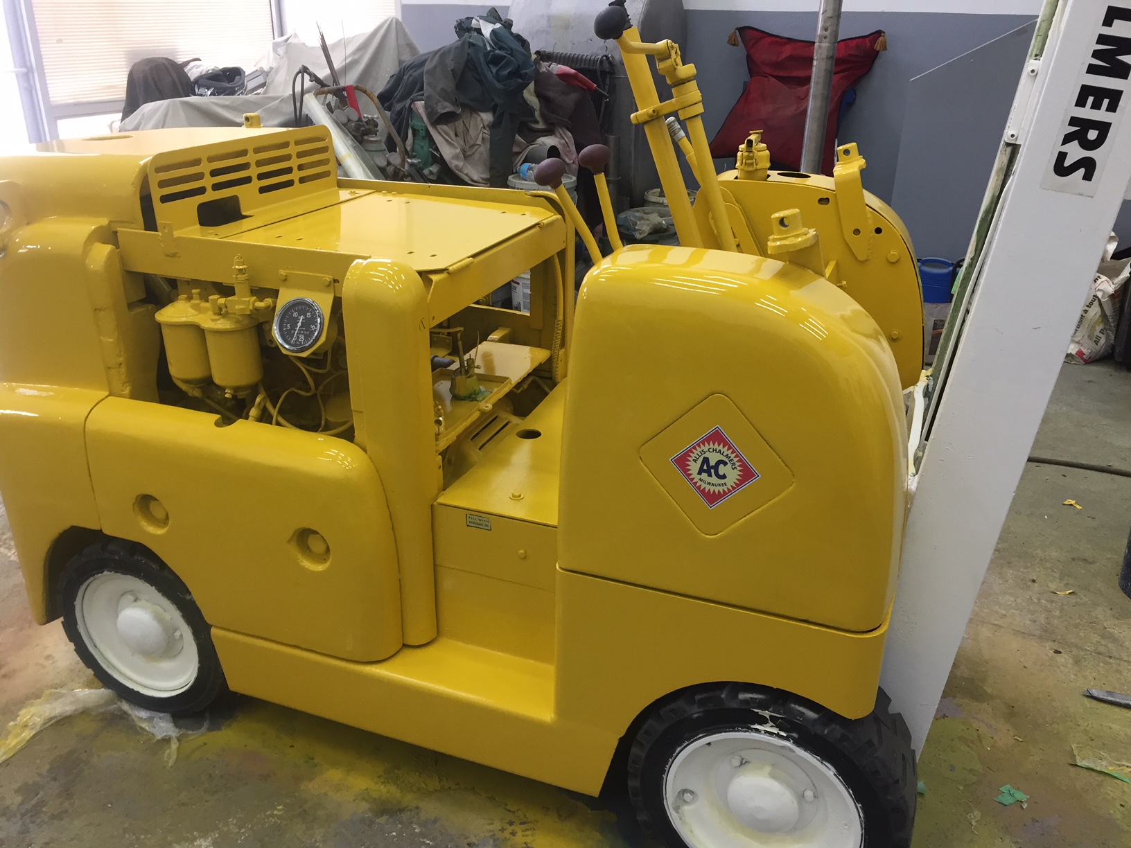

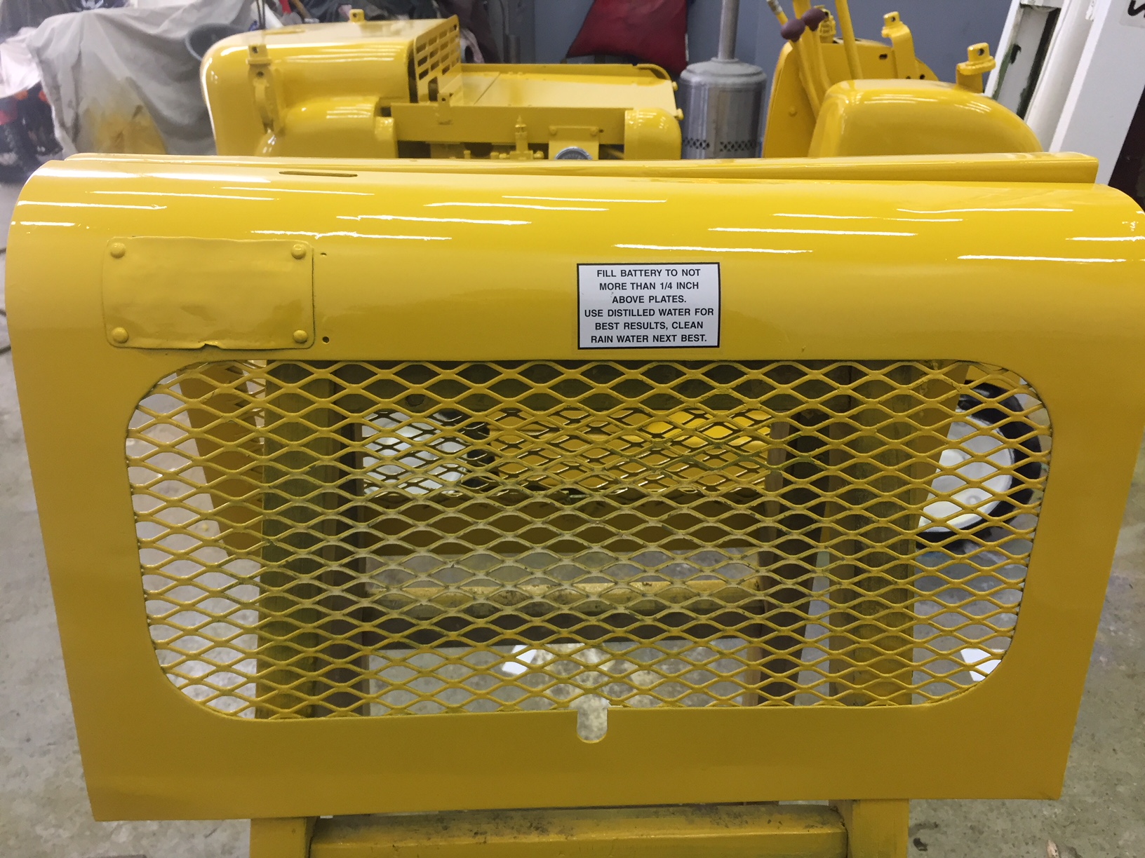

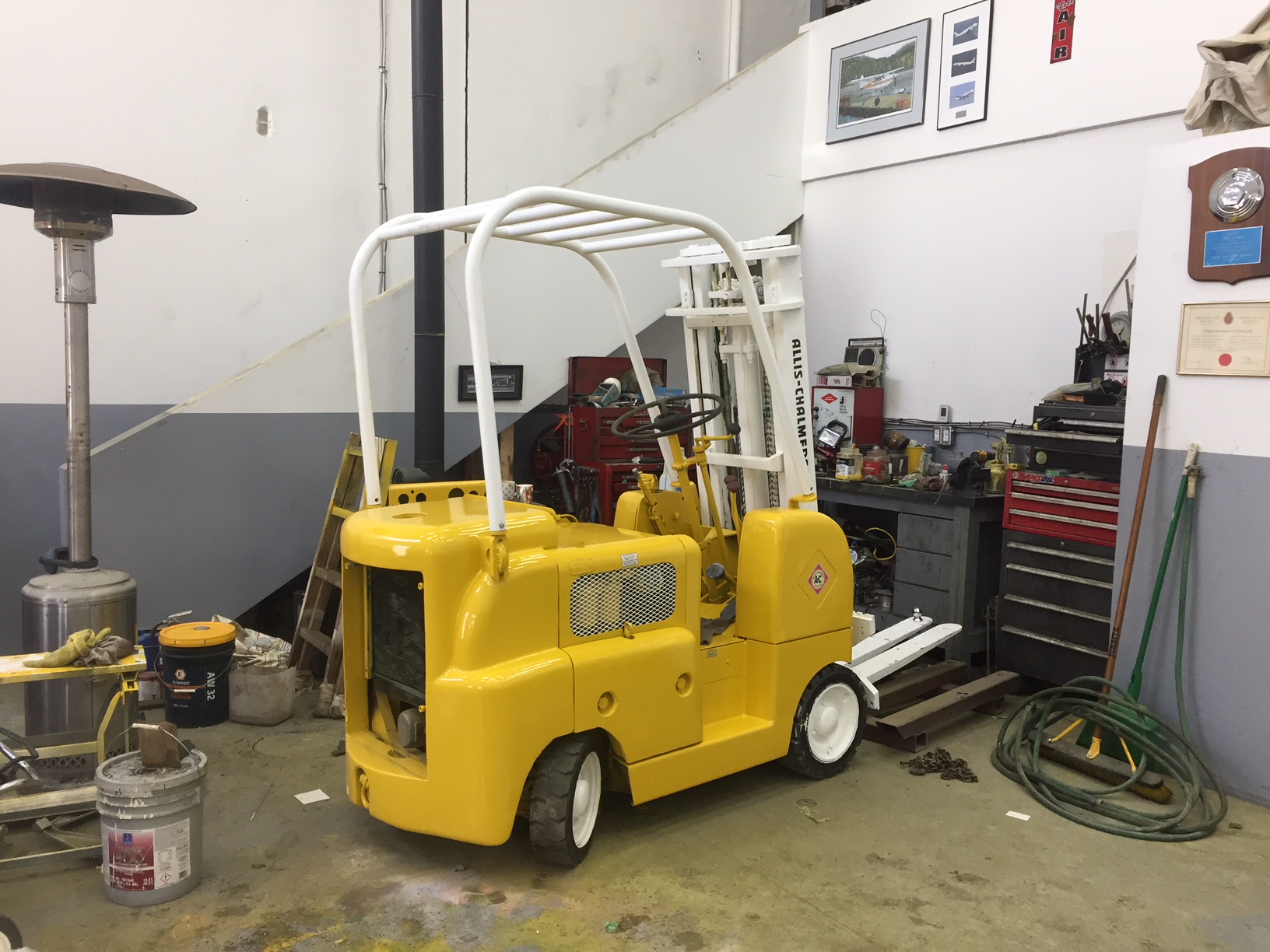

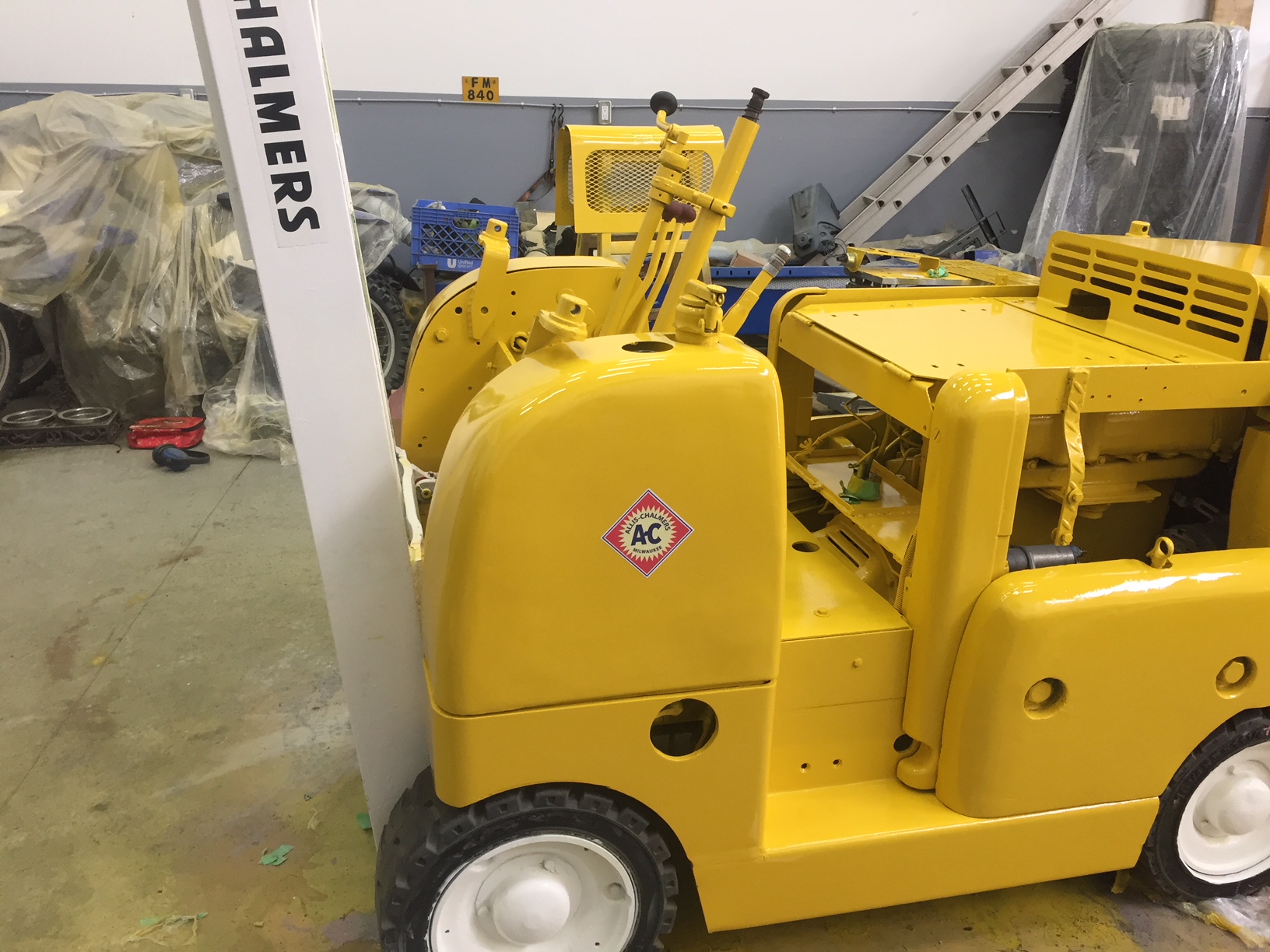

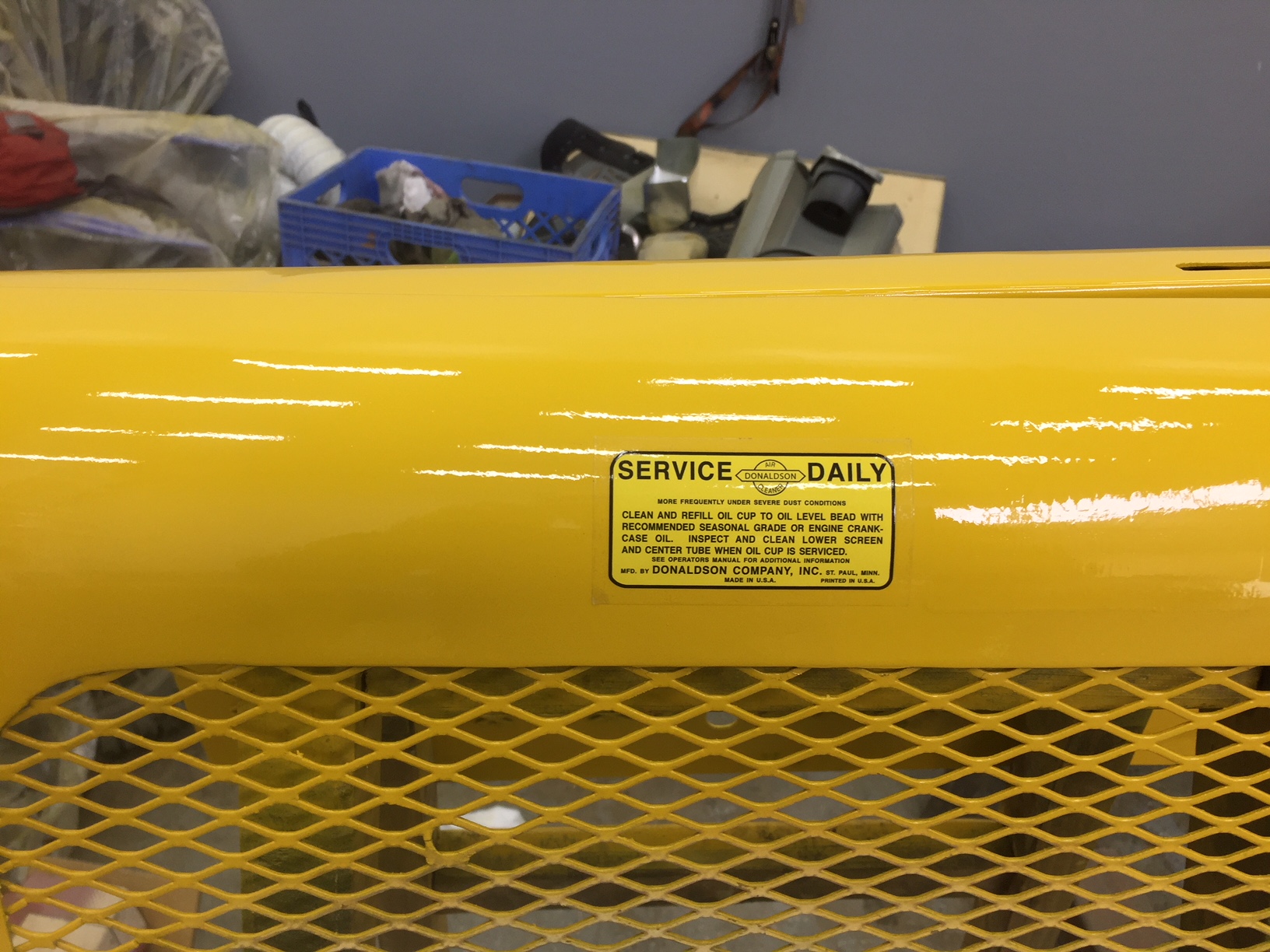

Just a little update on Allis.  I did the rest of the bodywork on her and painted it yellow.  All thats left to finish is build a radiator guard, finish the dash,install new guages, electrics, start switch etc and she's finished.:)

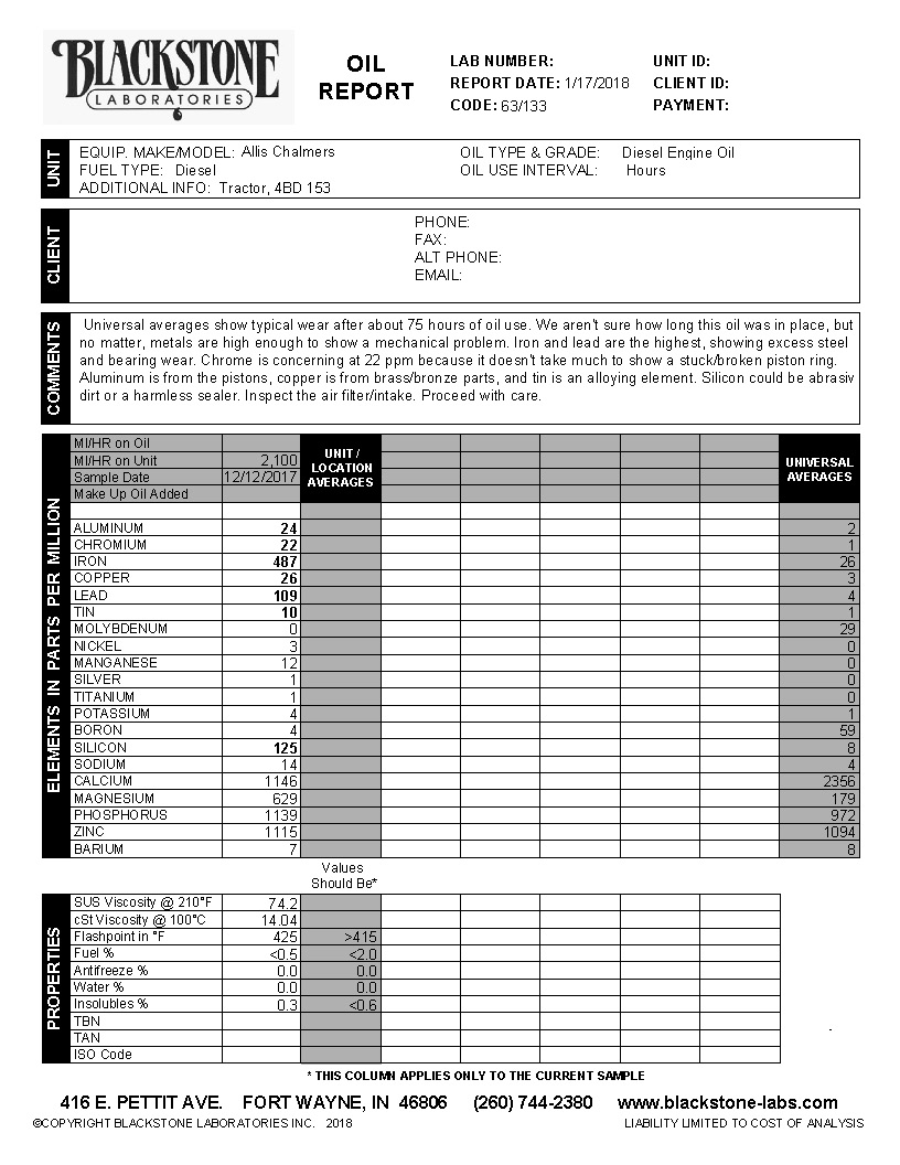

Here's the oil analysis of the oil I drained out of the crankcase before I pulled the oil pan off.  I've now run the engine 5 hrs under light loads and for long periods at 2100 rpms to try and burn the carbon out of the engine.  I've drained the oil again and sent another sample off to make sure there is no coolant in the oil as the welding I did was with the liners still in the block.  In the future I might treat the engine to new liners and bearings. Oh the engine happens to be a Buda D175 not a BD153, something I learned later after my first report was sent.  This report gives you an idea of how badly it was treated.  No oil changes, no air filter, no grease or maintenance of any type was done on this unit for years, maybe decades.
Here's the report.

Before you change the oil again, put a few more hours on it and draw another sample, compare it to the 1st one. You might want to do a 3rd one to get a better picture of activity inside your engine. Back in the 70's and 80's I became involved with this it was very interesting. Good Luck with your project. Its looking GOOD.

Thanks, I'll post the results from the 5 hr run when I get the report in a couple of weeks.  If the report is good, I'll take another sample in 20 hrs or so and see what it looks like.:)

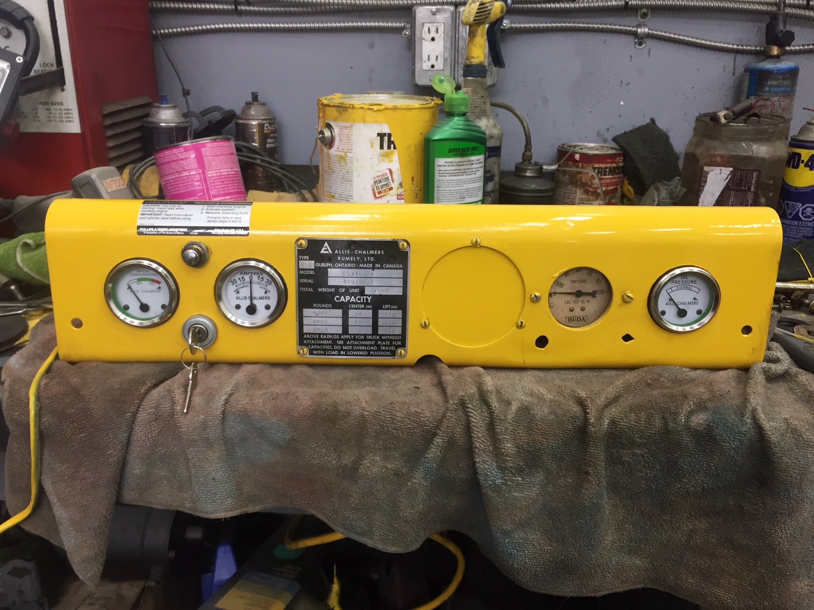

Here's the new gauges installed.

That dash looks great! Nice job.

Thanks, gauges and decals are from a model C tractor.  I did try to find forklift gauges and decals to no avail, so model C it will be.:)

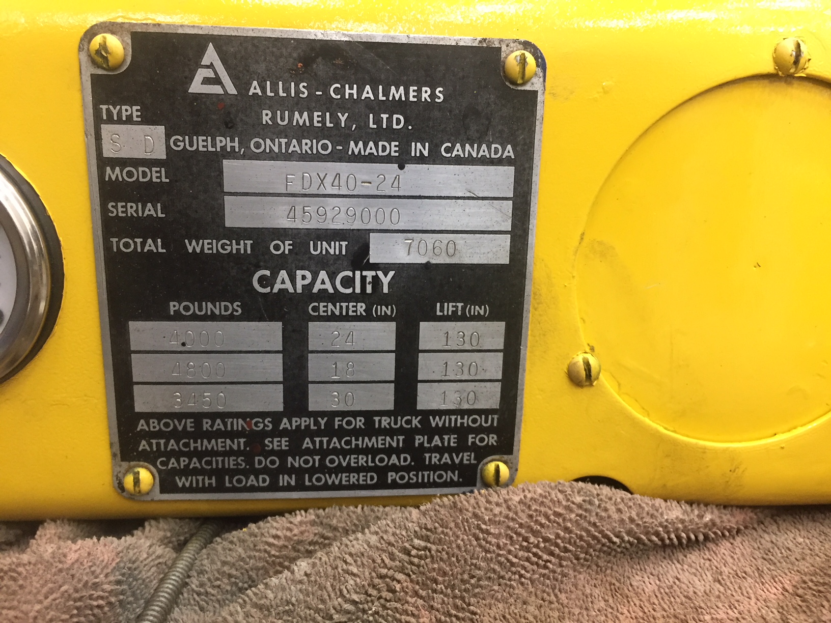

A310 what is the lift capacity of your lift and would you be able to tell me an approximate weight on your machine. I have found one that I'm interested in that is similar to yours and I don't want to spend more on it than it is worth . Thanks

Hi Corey743, The forklift's weight is 7000 lbs and will lift 4000 lbs.  If you look at the dash picture above you can see the capacities.  I'll take a close up picture of the tag and post it this afternoon so you can get a petter veiw.

Here's the listed capacities.:

In the dash picture ,is that a pressure gauge in the far right ?
