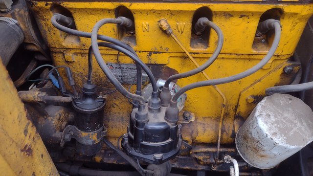

 The F40 has starting issues, Yea I have only done a farmers tune up, fixing a bare wire going into the distributor and cleaning the points, rotor and cap contacts.

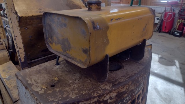

 I am starting to fab the brackets to hold the gas tank. It has been setting on blocks of wood for a while. (I have to age these projects like fine wine):)
If anyone knows the points, rotor and cap numbers please let me know.

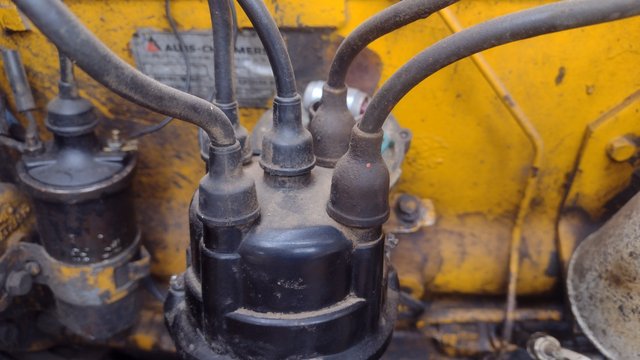

I would like help identifing the distributor type/ style numbers? would like to go to NAPA and get points rotor and cap.
Also the custom mounting base for the gas tank. It is bolted to the counter weight.

Post Options Post Options   Thanks (0) Thanks(0)   Quote Eric B Quote  Post ReplyReply Direct Link To This Post Posted: 30 Nov 2023 at 11:15pm
With the cap off you may find the distributor tag# if you can use a mirror to see around the back, if necessary. Of course better yet, if you pull the distributor out, as the digits are so small. If I remember right, I think the points are the same as in the Allis tractors. You could pull the cap off one of your tractors and compare.

Eric, Folks,
 I will try those ideas, thank you! This cap has screws holding it to the base, compared to the other Allis tractors we have. I have a new set of points for the CA. I will look at those.

Only yellow I had but the fuel tank is MUCH more secure:
