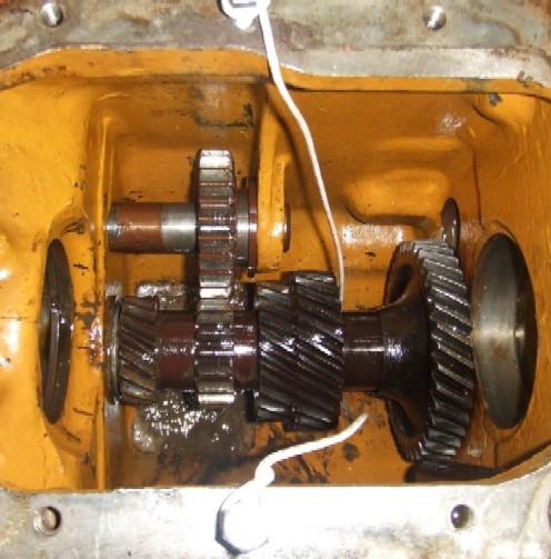

pre64, in your picture of the cover I see what looks like 2 shim washers on the rail  in the book does not show them, and with the wear on 1st- and reverse idler leading edge's it don't look right,  the shims on the counter looks like the front spacer should be (0.868) and the rear should be (0.966)

This morning I took an inspection mirror and looked at mine, the spacer in front is about 3/8" wide, and the one in the rear is about 7/8" wide, these are rough guesses as I couldn't get anything in there to measure them.  When the tranny is in 1st gear, the reverse gear should be all the way rearward up against the back mainshaft gear, and there was about 3/16" or maybe a 1/4" of clearance between the countershaft reverse and the reverse idler gear, with the spacers reversed, they would probably mesh.

Well fellows we will know shortly. Just got it split and the power director off. As soon as I eat a bite I will be pulling the main shaft and working my way down. Should know something in a few hours.

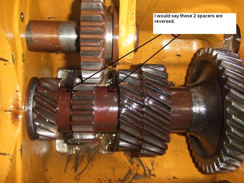

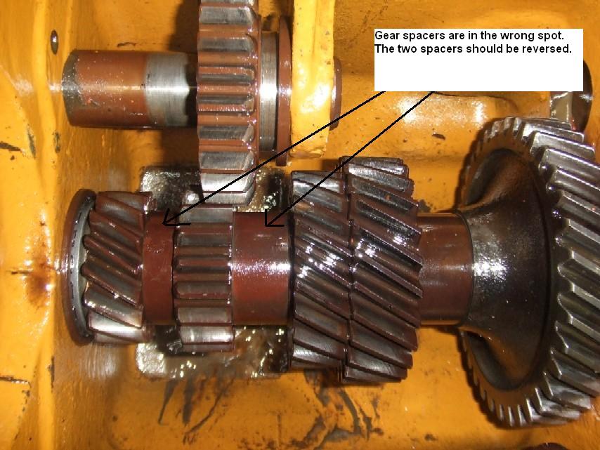

I didn't get to work on this yesterday as planned, but I got it tore down today. Take a look at this picture and tell me if you agree with me the 2 spacers are reversed?
Thanks

Yup.

Dr. Allis
I see what you mean by driving out the counter shaft to replace the bearings and races. I think however it would be very difficult to slide the shaft out far enough to pull 2 gears and spacers off and change them around. If you work alone as I do I would say no, however if you had a couple of extra hands and they were small I would say maybe on a lucky day. Small hands and lucky days seem to flee from me however. I have posted a before and after picture of the spacers being in the wrong location. I want to thank you for all of your help. Hopefully others have learned as well.
Thanks

You'd have thought the person responsible for the mistake would have noticed it after together and groaned and fixed it.
Yes, you and I think alike, but not everyone has to sign-off on their work or feels compelled to do their work to a standard.  Too bad , it causes a lot of grief for the innocent !

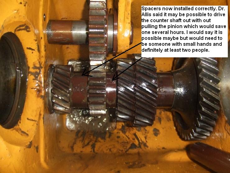

Here are the before and after pictures of the spacers on the counter shaft. My advise to all is to pay attention and take pictures of all of the parts if you are going to rebuild a transmission yourself. Some poor soul probably paid some several thousand dollars for this repair and it was done wrong.

well,the bright side to the story is you didn't have to buy hard parts to fix it

Glad you got it headed to working properly, sorry you had to tear into it so far, but as Steve pointed out, no hard parts, just a few gaskets and seals.

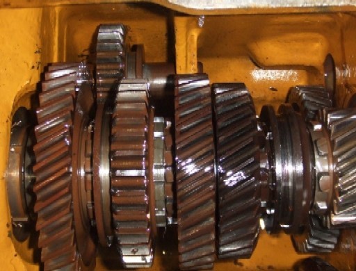

Thanks everyone for the comments. Had it not been for this site and everyones willingness to aide a fellow Allis collector, things may have turned out much different.
  I will be posting a couple of more pictures this week of assembly and some pointers for doing the entire job alone that will hopefully aide some of you in the same situation. I work alone 99% of the time so I am use to developing tools and tricks for helping me through it.
  I have now assembled the counter shaft gears and reinstalled the pinion shaft and main gears, and tried all gears to assure they are working correctly. I know a couple of you are wondering if I cleaned out the crud down in the housing that shows up in the picture and yes I did.
   I am at a stand still now waiting on seals and gaskets and hopefully will have them by the weeks end. More to come!

Man , what a painful learning experience( even from the sidelines ) !
I've always been impressed with the knowledge that you guys freely share and those 2 pictures showed WHY we should always take pictures before we tear into something and ASK before commiting to putting it all back together with fingers crossed, hoping this is the right way

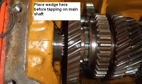

    Follow the book and remove the bolts from the axle housing bearing retainers. These housings have an oring seal and are about 2 bucks from Allis so don't consider reusing them. You will need to take a brass punch or small block of wood inside the differential housing and tap out the bearing housings outward until they are free. Once the oring is out of the housing they will come off easy. Make sure you replace the seals in the housing before reinstalling. Your ring gear assembly is now free. It is heavy and sharp so some gloves may be nice. You will need to hold it up and pull the dowels at the same time. When you remove it bring it straight back out the rear. There is not much clearance here!
     Next you will be ready to remove your hand clutch and the main input shaft according to the instructions. You will notice that most likely your will encounter snap rings that have no holes in them to remove them and not enough room to get anything else in their to aid in getting them off the shaft. What I do now is get a small, good sharp center punch and mark each side of the snap ring and drill the two holes in them. Keep it under an 1/8" and centered or it will be too close to the edge. Now you can use your regular snap ring pliers to remove it and possibly save it. The material of the ring is a little hard so make sure you have a good fresh bit to drill with, but a regular steel bit will work.
     The book says to just tap the main shaft out the rear housing. Hope yours comes right out but I bet it don't. It may take a lot of tapping to drive it out. Mine came out hard all the way to the end. You have a double roller bearing with a couple of inches of surface so a normal tap isn't going to cut it. If you do not have a large brass shaft or punch you will probably need to find a small oak 4x4 and a 3 lb hammer. Before you begin this so called tapping I would advise that you put some type of a shim wedge between your 2 piece split ring collar and the rear part of the main shaft. I broke one half of my split ring from driving on it and could have prevented it by putting a wedge between it. Once you have moved it about 3/4" you can slide the collar back and remove the split rings. Now is a good time to get you a shaft, broom handle or something similar a couple of feet long and clamp it to the rear differential somewhere close so when the pinion shaft comes out you can start taking your gears off and sliding them right onto the shaft so you don't mix up how they go. Also if you are working alone it would be a good idea to stuff something in the differential incase the pinion comes flying out or drops and dings up your bearing. I put a bunch of my dirty rags in mine. Any comments or criticism is welcome. If we can improve this no hard feeling here! I will begin to write some assembly tools and tips as well in the next few days. Also are a few small images to clarify some of text.

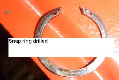

   You will find that some of the gaskets come off very hard after the years. I still prefer using a razor blade scraper to get down to the metal surfaces. You will notice that some of the casting flaws will catch on your blades every now and then and break your blades (make sure you have your safety glasses on for this) so make sure you have a handful of razor blades before you start. Once you have all of your gaskets cleaned off, clean out all the junk from the housings and swab it out good.
    Now get all your pinion and main shaft parts and gears ready to go. Here is a tip for putting the pinion shaft in yourself . Get you a couple of feet of good wire and put two bolts in your top transmission housing straight across from one another near the front of the transmission. Wrap one side of the wire 2 or 3 turns around the bolt farthest from where you are standing and leave the other end of it hanging. Get your pinion shaft and place it through your back housing all the way to the bearing edge and hold onto the shaft with the other hand. Now with one hand free start feeding your gears etc onto the shaft. Then in order to free up your other hand grab your wire and loop under the front part of the shaft and lift it up until it is nearly centered in the front housing and give it a couple of wraps around the other bolt on the top housing. This will temporarily hold it in place while you go to the rear and get your pinion started up into the bearing housing. When you get ready to do your so called “tapping” your shaft into the housing you will need a hard block or similar to tap in the center of the pinion and drive into place. When you get within about ¾” or so from being into place, you will need to put on your “split ring”. I usually grease them up good with some heavy grease so they will temporarily stick into place and not fall out. Slide your retainer over the top of them when done to hold it together. Don’t be afraid to put a wad of grease on this as well to help hold it in place. Keep checking after each tap to make sure it doesn’t come apart. Note; when tapping your shaft into place you will need to keep slacking your wire that is holding the end of your shaft up. Once you have started the pinion into that bearing housing I realize the shaft holds it self, however the wire at this time serves to hold the gears from flying off the front of the shaft during the tapping process. This image is on the bottom shaft assembly but the same technique is used on the top:
    Once you have your pinion and gears in place make sure your gears all turn freely and each gear functions properly and is free. If your pinion shaft is binding at all you probably drove it in a little to far. If this happens make sure you have your snap ring on the front of the shaft and then give it a good tap backwards and it should free right up. If all is well and you get your rear bearing retainer plate on and all bolts tight, you will need about 18-20” of steel wire .050” or less in diameter  to put through the bolt heads as the book indicates. End up with your splice for the wires where you have room to work and about ½ way in the middle of two bolts. This will give you enough room to twist the ends together. Once done clip off any excess and flatten all wire down tight against the flange. This will prevent it from getting caught in your ring gear.

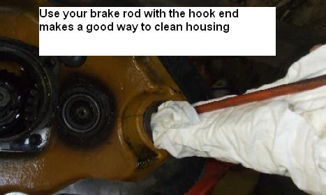

    With all of your parts cleaned good install all of your seals. When you are installing the new orings, especially the ones on the rear axles bearing holders, do not roll them into the grooves they fit in, but rather start one side of it down into the groove and “carefully” stretch it just enough to get the remainder of it into the groove. This will prevent the oring from twisting that you get from rolling it into position. You want it to lay straight when it is in the groove to prevent from catching during assembly, since it is a real tight fit. Right before assembly put a little Vaseline on it all the way around to help it go together.
    When working alone and installing the ring gear assembly into the housing you will need a couple of dowels, broom handles etc to fit though the axle housing into the rear end to hold it up during assembly. Once you have it suspended then you can get your bearing housing and shims and slide them over your dowels, line it up and carefully push them into place. Make sure all of your shims are lined up with the bolt holes during assembly. Don’t use the retainer bolts to draw your bearing housing into place. If it is clean and lubed you will be able to put them in by hand by turning them a little during assembly. This will prevent you from pinching one of the orings. Once they are in place tighten them up, Check now and insure it rotates freely and your ring gear and pinion gap are good. If you have kept all of your shims straight on each side it should go back to where it was. If you don’t have the dial indicators etc. to check exact clearance make sure that there is a little play back and forth between the ring gear and pinion. I would say no more than 1/8” back and forth just as a guideline.
     When you are ready to install the rear axle housings I like to use the engine hoist and put the strap as far out as it will go and it will be balanced then. Make sure your brakes are spread clear apart and put a little grease on the ends of the splines to help it to go together easier. Once you are lined up and ready to start the axles into place, go easy and not bump the inner seals. If you have it lined up it should go in a good ways and stop. At this point turn your outer wheel hub a little back and forth and it should go all the way in. Never draw it in with the bolts, it should always go together fairly easy by hand. Also keep an eye that your don’t catch on your brake shoe linings going in.

    The tractor is back together now and everything works as it should. Other than a little more painting and some finishing touches it is done. Once it is all done I will post a final picture of it.
    I want to thank all that helped on this. This is a great forum!
